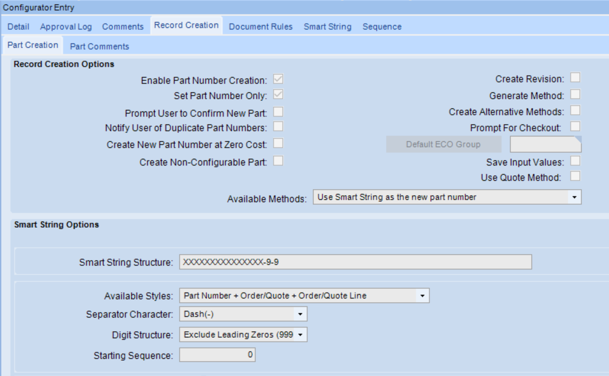

We have our configurators set up like this. We do not need to keep the part number in our inventory after
it has been created. Because we use the Quote Number - Release Number - Line Number, with the Product (Configurator Part) as the preface, to build the part number each one is unique and easily retrieved for reports/dashboards, etc.
No need to auto-delete, the part never gets added to the inventory (Part table). It is generated on the fly and only exists on the configured line of the Quote / Order / Job, where the BasePartNum is the configurator part number (Hope that makes sense)
