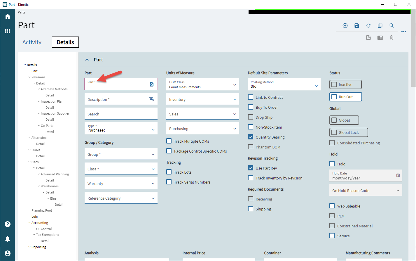

Required fields look to have asterisks.

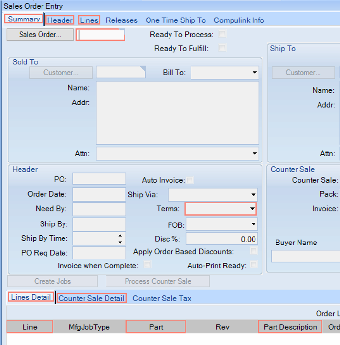

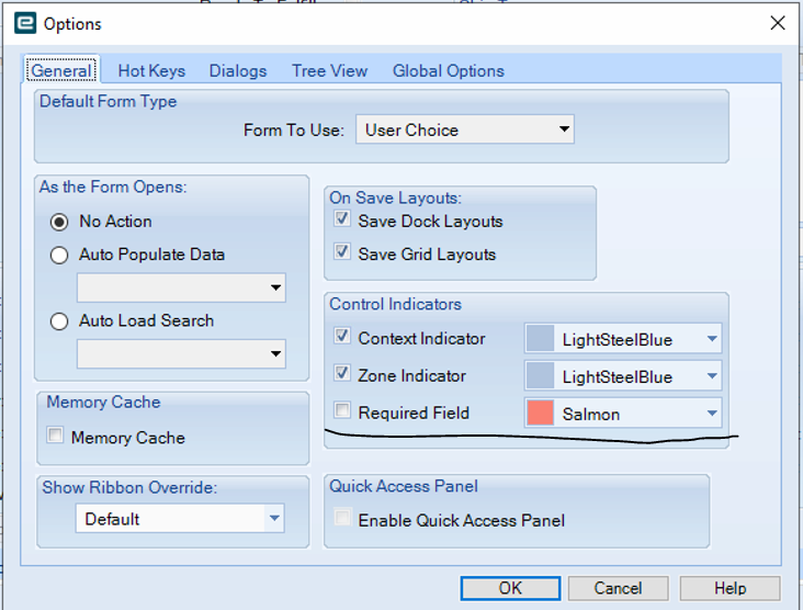

There has been a way in classic going back to 9 that a user can show the required fields. It is by screen, so it does take some setup for them.
