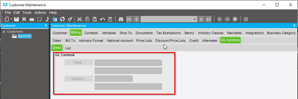

Has anyone had success in making GL Control Codes Mandatory in Customer Maintenance?
The idea would be to have users enter the GL Codes before being able to save/update a customer.

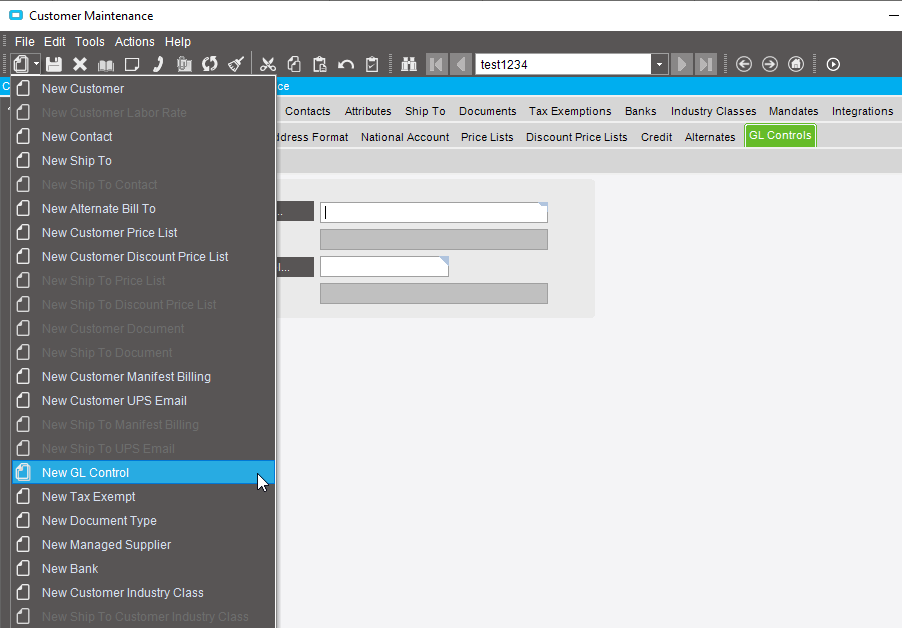

The problem is that I can’t target the GL Control fields until after the “New GL Control” has been added.
