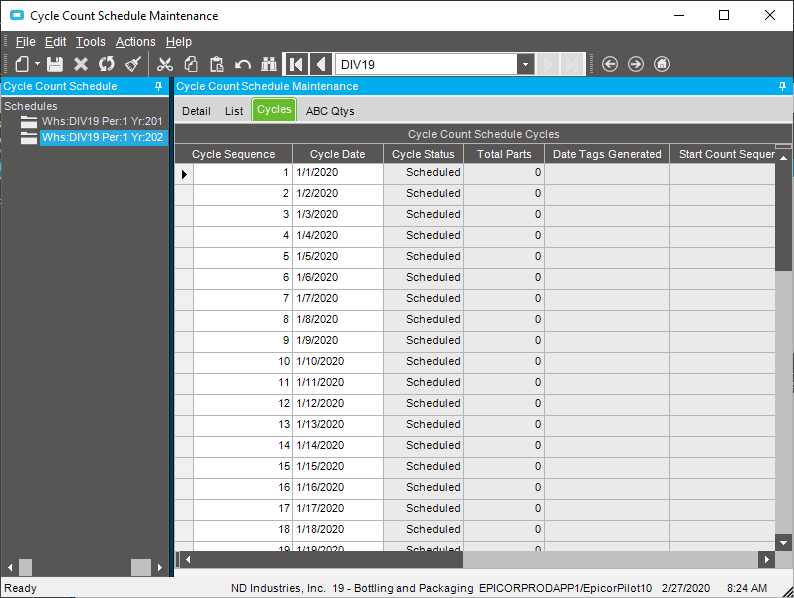

Is there a way in Epicor E10 that I can enter Cycle Counts like I used to in Vantage? I want to create a new Cycle Count Group and either manually add the parts I want to count or Paste Insert the parts I want to count. I do not want the system to calculate the parts for us to count, so I want to avoid this process completely. Can someone please tell me how I can do this?

You won’t be able to do it EXACTLY like Vantage. You must still define your Cycles ahead of time. Go into Cycle Count Maintenance and define the days for the Warehouse you are going to count. DO NOT run Actions | Part Selection.
When you’re ready to count, open the cycle count for that day using Cycle Count Part Selection Update. There should be no parts there. Now just paste the parts you want to count into the grid.
Continue as usual with Cycle Count Maintenance and Create your tags, Start your Count, Enter tags, etc.
