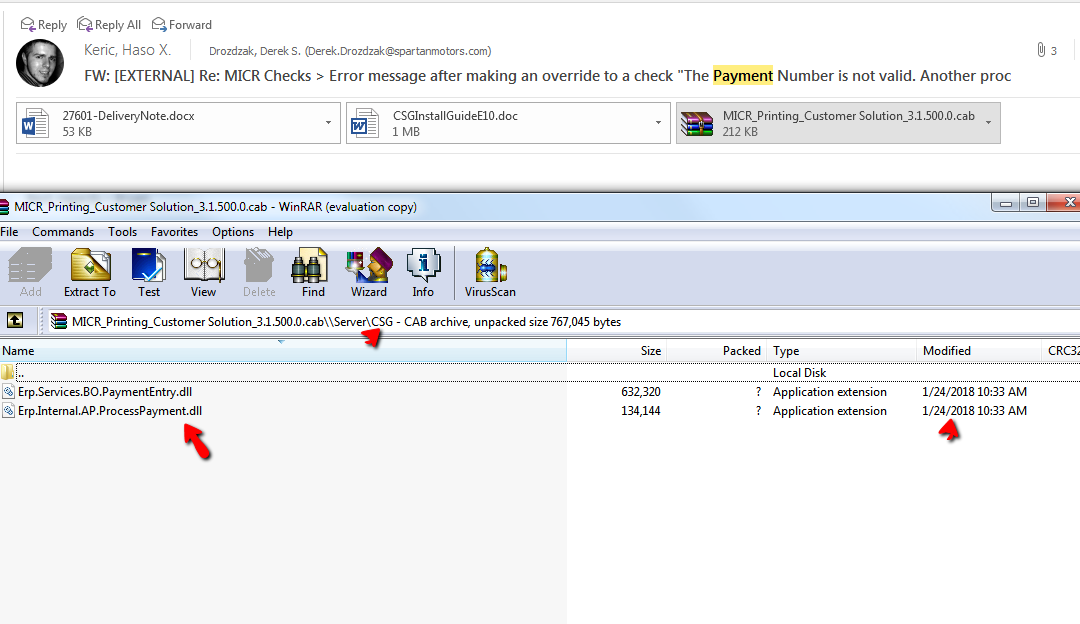

Can you check on your Server in CSG Directory what your Date is for these 2 files: I remember in January we had an issue with the Payment Number not auto-increasing and more… So they sent us a fixed and apparently patched it on EpicWeb.

We have done those things but the dates on those files in my server directory are 12/4/2017 rather than the 1/24/2018 that your image is showing. I had downloaded the newest MICR 10.1.500 files I could find on EpicWeb about a week or two ago, so I just now went back through the process and redownloaded and found that they were the same ones I already had.
So it appears that the EpicWeb files were never updated after they made the correction for you. My best bet then it seems is to let my ticket play out and hope they bump into the solution they did for you.
And actually on closer look I don’t even have the file Erp.Services.BO.PaymentEntry.dll. The file is not in my CSG directory on the server and it is not in the downloaded ZIP file from EpicWeb (either one of them).
They must have never added it to EpicWeb… I can send it to you in PM you can place it quickly in CSG and do a IIS Recycle and try it, its built for 10.1.500.x
