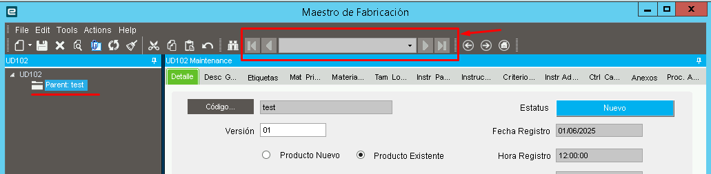

Manually Populating the UD102 Screen via Code
I executed this code to manually populate the screen via code, and it works except for the data navigation object. Has anyone experienced this issue? Was it resolved?

@adaniell
I hadn’t noticed that the navigation control uses a different EpiBinding than the rest of the screen, I just assigned the result and that was it.
