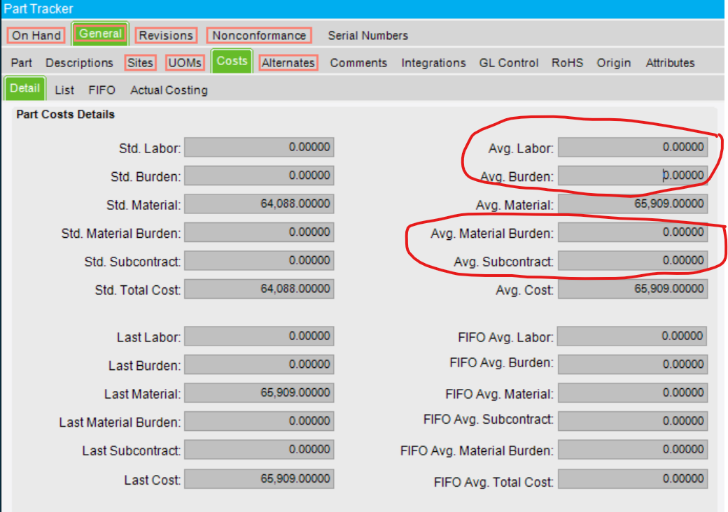

but, all parts in our Epicor Part Tracke have no Avg.Labor/Avg.Burden/Avg.MtlBurden/Avg.Subcontract values.
So I want to know from which menu field I get the value of this field.(Indirect way rather than direct update by parts maintenance)

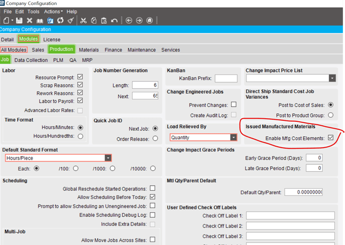

You have to check this box to keep those numbers split up. Your current cost all all of the cost of that part, because it’s not split. Check this box, and it will keep those numbers split up through the process.
Thanks for your help.
After changing the setting, it will be applied from the next job, so I will check it when creating the next job.
I checked this checkbox and then completed a new job. But still the above Avg values do not appear.
Where does this Avg.Labor/Avg.Burden/Avg.MtlBurden/Avg.Subcontract value come from? What do we have to enter for that value to appear?
Did you receive the item to stock? It will not populate those values on part tracker unless it is a transaction to stock location.

I have even completed the Job Receipt to Inventory task. But still no Avg.Labor/Avg.Burden/Avg.MtlBurden/Avg.Subcontract values. so i want to know if i didn’t type something.
And the costing method is Std. In case of Std, does this value not appear?
Cost method has to be average.
