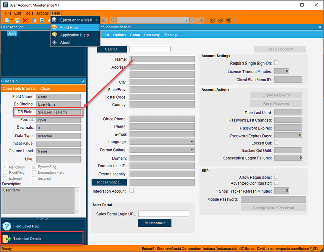

You can go up to Help > Field help.
Click into a field, then click the Technical Details tab at the bottom of the new slideout.
