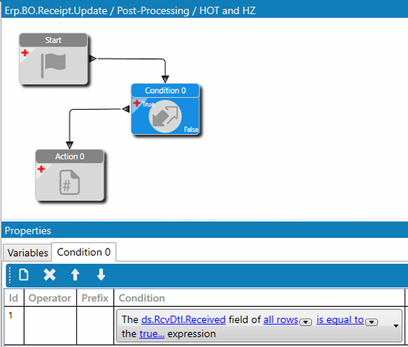

I do this in a bpm post processing on Receipt.Update
I have a condition that the received checkbox is true then the code below runs for all received lines. I stripped it down to just the Hot checkbox for the example. Obviously you will need to swap my variables for yours, but otherwise it should fire for Classic and Kinetic.

The wizards don’t really have a good way to loop thru the received lines yet, so this is the best way to do this alert. If you can read this code enough to understand that it is going to show a message then we can substitute your checkbox and message for mine and it should work. I have a complete file of code snips I have gotten from this site I refer to that I have gleaned over the years that help me.
This is the bpm condition and the code below should work with your variables.
