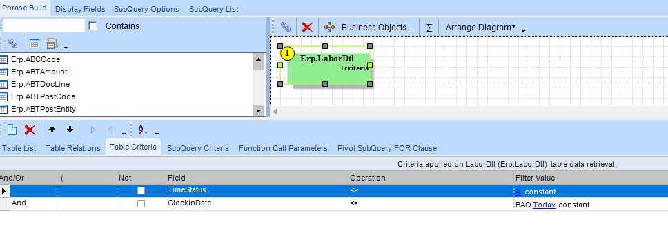

I do this with a UBAQ
I have a BAQ I use to FIND bad entries… but I never took the time to turn it into an updateable BAQ/Dashboard. Perhaps you could take it to the next level.
Its just a simple BAQ against LaborDtl, showing whatever pertinent columns you want/need.
You’re just looking for any entries that aren’t approved (TimeStatus <> “A”)
Table criteria
TimeStatus <> “A” (approved)
ClockInDate <> Today (otherwise you’ll see a bunch of “entered” time records for active work)
