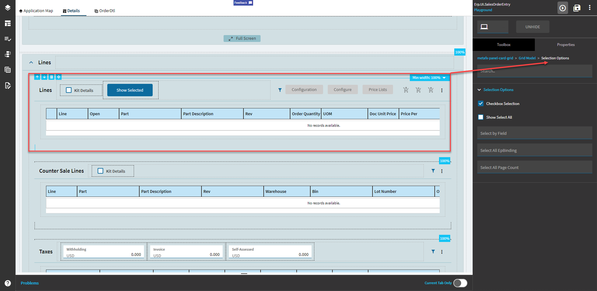

Does anybody know how to delete multiple lines on the grid using a custom button? Let’s say in the supplier price list. I want to delete numerous part lines for any supplier by selecting some rows in the grid and hitting the button.
You’re going to have to add a selector to your grid that marks the rows for processing, then use the button to iterate through each selected row, set as current, and call the event-next widget for the delete tool. There’s a post I’ve made around here that shows how to iterate through grids. Alternatively, do the same selector thing, then, for the button, have it compile each selected row’s key into a delimited field, then send that field to a function server-side to use the BO to delete the lines, then have it refresh the page after the function is done.

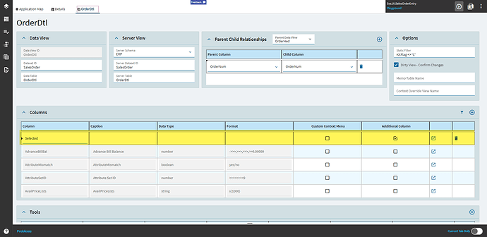

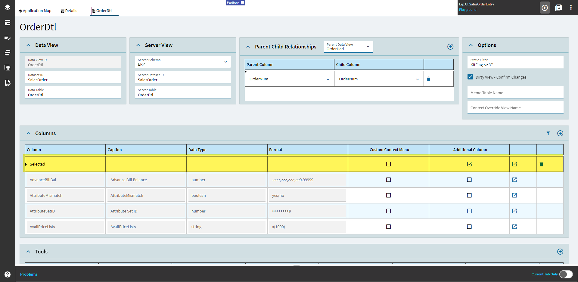

Here’s a few screenshots on getting the selector set up:
  1. Add a new field called “Selected” to your view

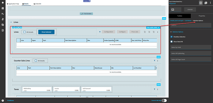

  1. In the grid’s Grid Model > Selection Options mark “Checkbox Selection” as true

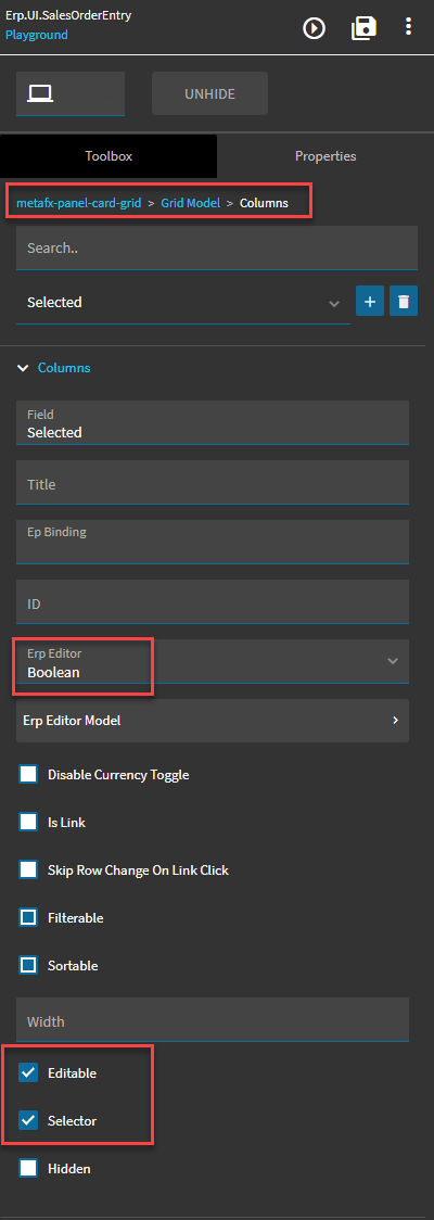

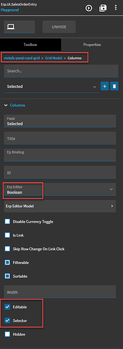

  1. In the grid’s Grid Model > Columns, add a new “Selected” column, set it as boolean, and mark it Editable and Selector
This will allow you to attribute the selection to a column in your view.

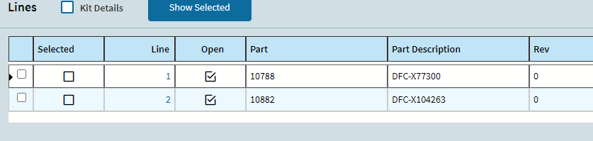

Selection
Then iterate off of the rows with that field and go from there.
Thanks hannah it worked :slight_smile: The existing dataview was read only. Even I tried to make editable it didn’t work. So I copy the dataview in my UD Dataview and then tried selectable. Which worked fine. Thanks again!
