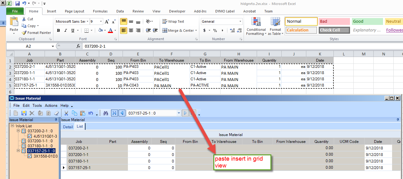

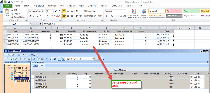

I am in E10 bu I just did a quick test of Issue Material paste insert on the list view and I think it could work for you, if the backflush idea doesn’t pan out and if Vantage interface for issue is similar enough.
See my screenshot below of testing taking data from sample row of a issue, into excel, update for some other jobs/materials, paste insert. There was some messaging for some rows (two middle rows), RE going negative, and UOM issue. I think they could be worked out with more testing.

Thumbs up to @Nancy 's idea.
In V8, UOM shouldn’t be an issue. But only trying pasting in a dozen or so rows at a time. V8’s paste insert is VERY SLOW, and prone to stopping.
We went through and manually issued the material. It took way too long but got the job done. Next time I will have to try Nancy’s suggestion.
