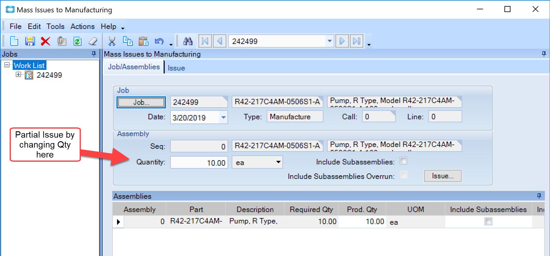

A Production manager called my attention to behavior in Mass Issue that I had not see before. He did Mass issue on a job that had a production of 10 , inputting to only Mass issue for 2 to start (per screenshot). This worked fine. Then the next day he went to issue 3 more and it will not do it. No more partial issues. It leaves zeroes in the Quantity Issued grid. It will only allow him to Mass issue the remaining full 7, then it completes the Quantity Issued. I told him to take down the job prod qty to 5 temporarily, if he really wants to partial issue. I toyed with teaching him how to take it to Excel, input what he wanted and past update, but that feels ripe for error. Any thoughts on this out there?

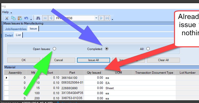

But you are looking at the ā€œCompletedā€ view (Purple arrow below). What do you see if you click the Open Issues button (green arrow)?

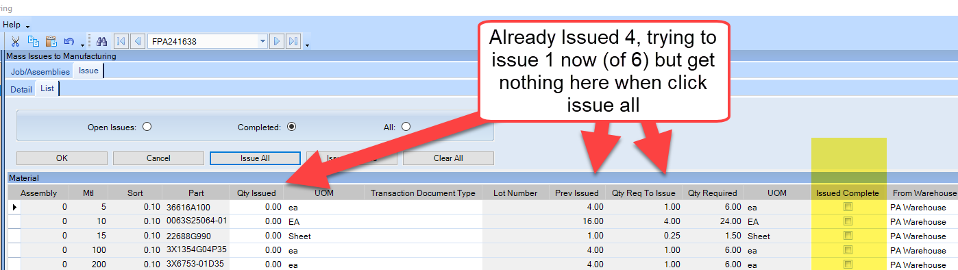

When I come in, Open Issues is checked. Then when I push ā€œIssue Allā€ button (to issue my 1 (parent) required to issue) it checks completed per earlier screenshot but leaves all the Qty Issued blank(0). If I do something other than click Issue all with the Open issues checked, it does nothing.
We have found this to be a little ā€˜Wonky’ also. the first day of issuing 2 works fine. On the second day , if you want to make another 3, you have to mass issue 5. The hint was that you only had 7 left ( out of 10) which is 10-3 ( the last mass issue). if you were to go to day 3 and try to mass issue 2, it would not let you because you already issued 3. In other words, Mass Issue is cumulative not additive. I hope this helps.
Here’s what I did and what I see.
  1. Job has a production Qty of 7, and no material issued so far.
  2. Launch Mass Issue to Mfg and enter Job number
  3. Mass issue populates the Assembly Qty to 7 (expected as the Production Qty is 7)
  4. Change the Assy Qty from 7 to 2, and click the Issue button on the
  5. The Mass Issue window switches to the Issue -> List Sheet, the Open Issues radio button is checked, and the Qty Issued column has all zeros.
  6. Click Issue All button
  7. The Qty Issued column now updates with values equal to Qty Per x 2 (the qty from step 4), and the Completed radio button is now marked
  8. Click OK to issue the qtys shown in step 7
  9. Close Mass issue
  10. Checking with Job Tracker shows that 2 x Qty Per has been issued
  11. Launch Mass Issue to Mfg and enter Job number
  12. The Assy Qty shows 7. You’d think it would be 5 (the original 7 minus the 2 from the previous mass issue), but it doesn’t.
  13. Change Assy Qty to 3, and click Issue button
  14. The Mass Issue window switches to the Issue -> List Sheet, the Open Issues radio button is checked, and the Qty Issued column has all zeros. Just like the first time (step 5)
  15. Click Issue All button
  16. The Qty Issued column now updates with values equal to Qty Per x 3 (the qty from step 13), and the Completed radio button is now marked
  17. Click OK to issue the qtys shown in step 16.
    Note the Completed radio button remains checked, but the Qty Issued column reverts to zeros. Previous Issued now shows the Qty’s from both Mass Issues
  18. Close Mass issue
  19. Checking with Job Tracker shows that 5 x Qty Per has been issued
It seems that the Issue All but ā€œlocks outā€ to prevent double issues. This might be new since V8, as it used to happen to us all the time.
If I want to issue more to this job, I have to change the Assy Qty on the first sheet and click Issue again. Or just close and re-open the Mass Issue program

Ok, I’ve tested on a completely different part / job. I’m getting strange results here too. One thing that’s very strange is that when I try to issue a partial 2 (following initial 1) it fails first time around. Reopen and then try it, and it issues one, instead of the asked for 2. (I have 47 left on job to do). Wow. I think it’s Friday afternoon. :smile:
OMG! This is it. Thank you Dean. (and thanks Calvin and Kim too!)
Never in a million years was I going to get there on my own. Cumulative… how crazy.
E10 Help is the best thing since sliced bread. :sunglasses:
Ugh … And now that I look at my example, I see that an issue of 2, followed by an issue of 3, only had a total issue of 3, not the expected 5.
After the 2nd issue (which I thought was for 3), the qty’s matched what I’d expect for 3. But this wasn’t ā€œ3 moreā€, it was ā€œ3 in totalā€ā€¦
