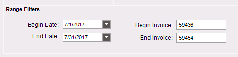

The Selection page has an area with date and invoice ranges
But entering that info, and leaving the filters blank yields the “No invoices selected to print.”
I have to go to the Filter -> Customers tab, search for customers, and select all, in order to get the invoices matching the Range criteria to print.

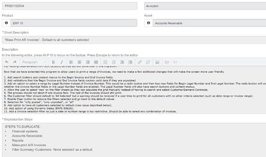

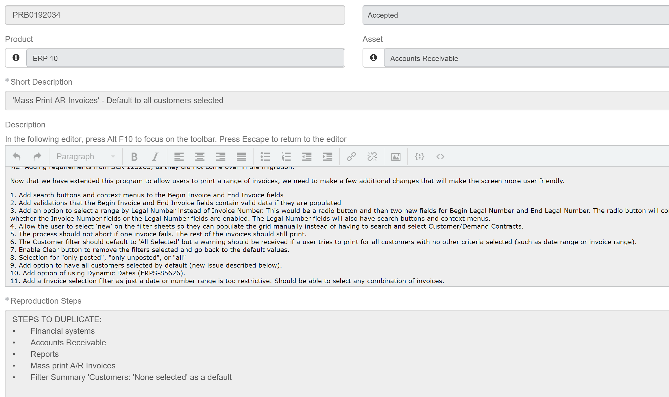

I see there are development tasks in EpiCare about this, but doesn’t look like anything has been done yet (as of 10.2.700):
