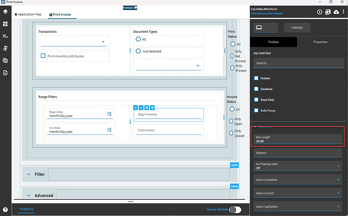

In kinetic you would change it here
doing it for both fields.
Interestingly leaving it blank just accepts whatever the standard length mask is (in my instance it’s x(9)) which sort of makes sense.

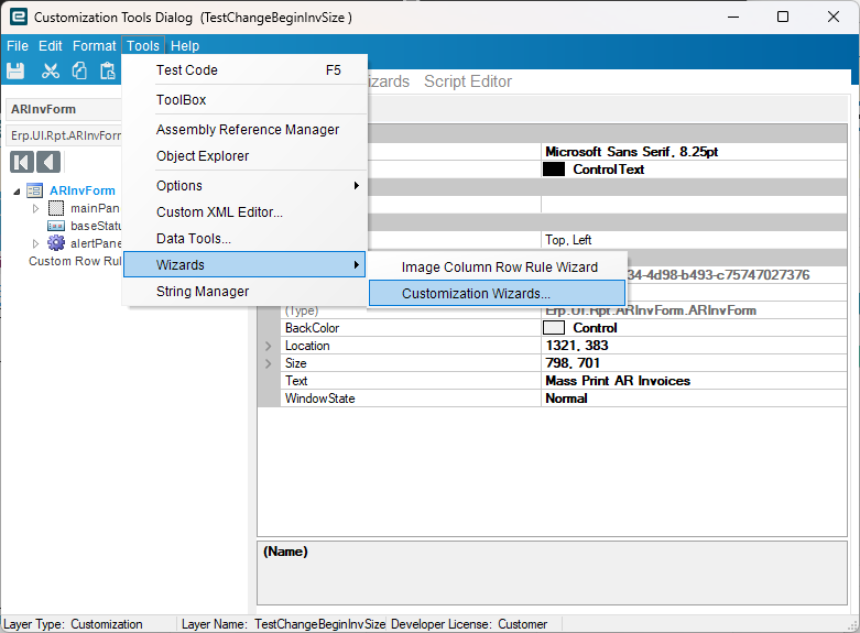

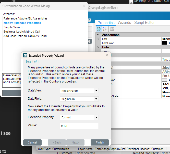

For Classic you would need to use the extended properties wizard.

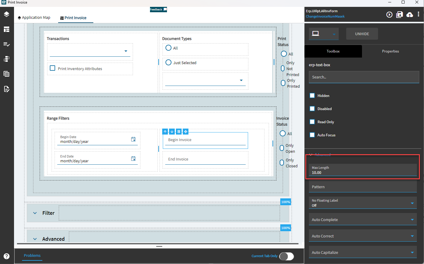

In my version, changing the Max Length property has no effect. The Begin Invoice field has an EpBinding = ReportParam.BeginNum.

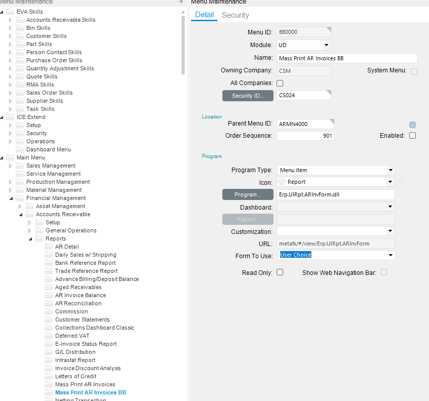

Copy the menu entry to the Current Company (in the overflow menu, iirc).
Then the Customization field will be available.
I copied Mass Print AR Invoices to the current company. It looks like the Customerization dropdown is enabled, but nothing is in it.

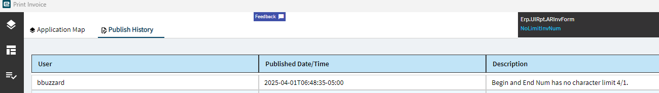

First I created a new layer, saved it and then published it. I added today’s date in the description so we could verify I was publishing the correct layer.
Next, I copied the Mass Print AR Invoice menu to a new one I labeled Mass Print AR Invoice BB.
Finally, I clicked on the Customization drop down and there was nothing.

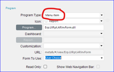

Since you made the change in App Studio… try changing this to Kinetic App:
Oh…instead of ‘Menu item’ for Program Type, it should be ‘Kinetic App’. Then the customization dropdown will be looking for the Kinetic customization.
That worked. Thank you!
