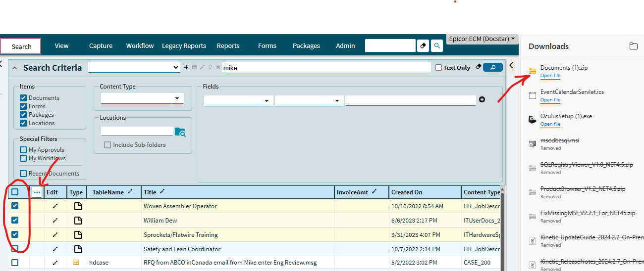

Non-programmatic answer is that if you can find them all in a search, then you can select them, and use the “Share → Save A Copy” on the Actions menu to download as a Zip file.
