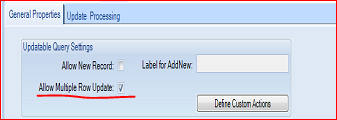

I think you will need allow multiple row update to make paste update active. Also be sure the grid is positioned at the top.
So I am still not able to do a paste update in either the BAQ or the Dashboard, I’m not sure what I"m missing. The dashboard doesn’t even have the option available when I right-click in the grid and in the BAQ the paste update is greyed out so not available. We are on version 9.05.702a if that makes a difference.
I started to do some testing to answer Calvin’s question and it did not make a difference on the multi row save. I had made the leap based on the one dashboard having paste update greyed out, but that made no difference.

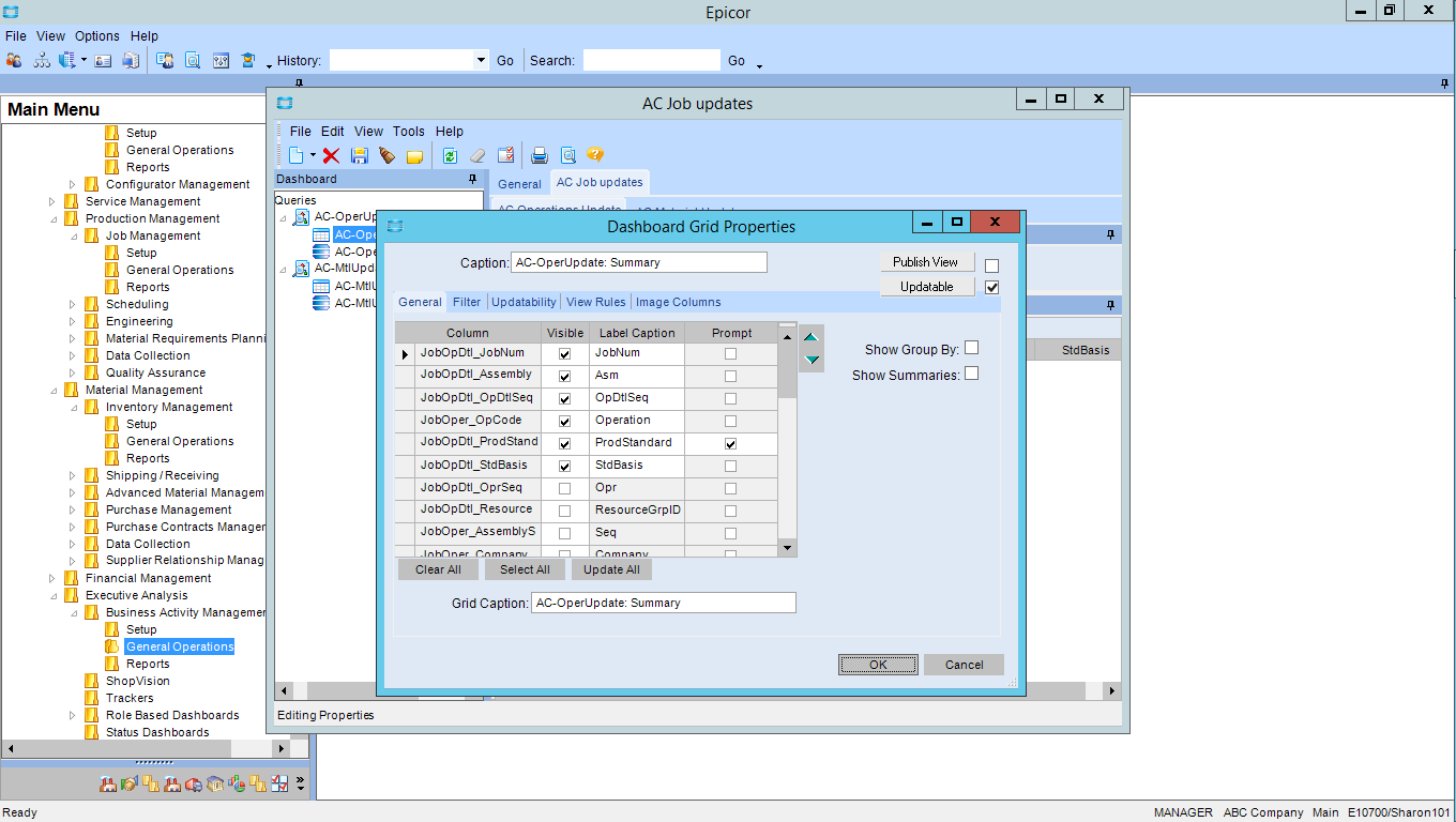

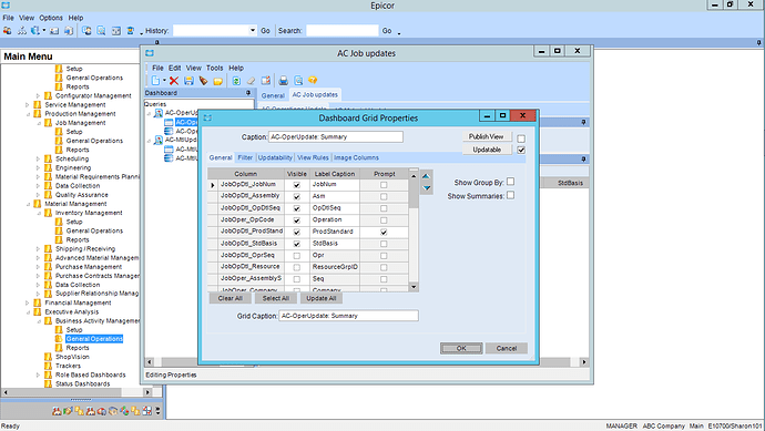

Lori, this is for E10 but the setup is the same. Make sure your dashboard
properties are set to updateable = true then use the Update all or select
the fields you want to be updateable in the dashboard
