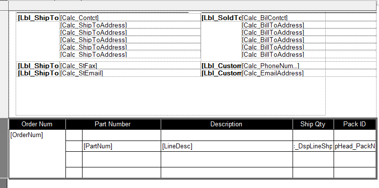

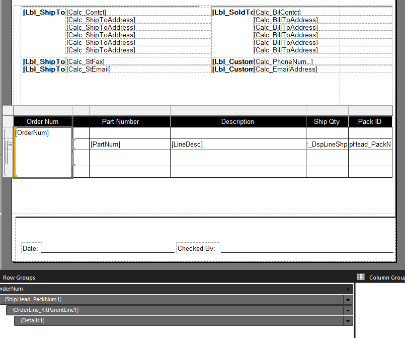

I am trying to get the master pack to break on the order number and have the address on every page. To this pint, I have not been successful. I have the a tablix for the address and then a tablix within that for the other info. Then I have it grouped by (lowest to highest) Details, OrderLine_KitParentLine, ShipHed_PackNum,OrderNum.
If I am seeing this right, the address fields are out of the control of the grouping, but I can’t figure out how to get the addresses in and still get the info as well in the format they want it.

I figured it out…mostly. I put the address in the header.

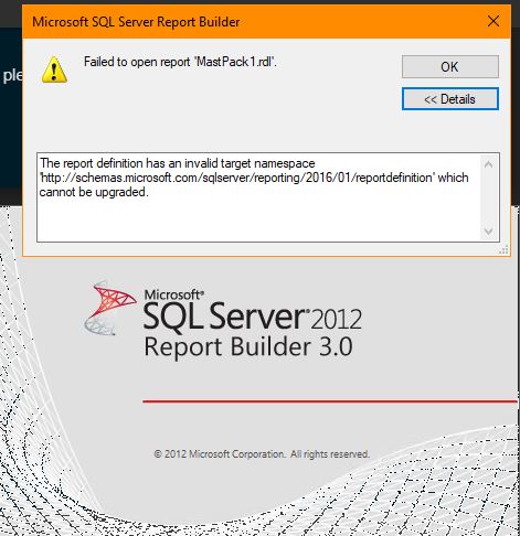

Is this not what you wanted? I couldn’t open your file.
Not exactly, but its doable for now. Did you get an error? Opens for me, so curious.
Maybe you’re using a newer version of Report Builder? I am still on 3.0.
Capture
Yeah, I’m a bit higher than that.
