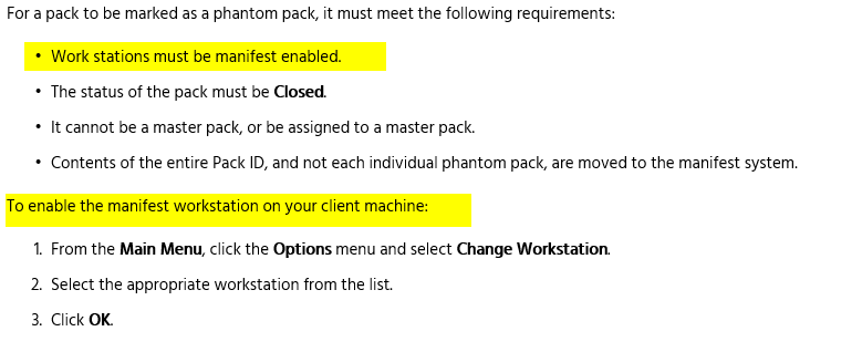

The help for the Phantom Pack Out did mention some requirements. So maybe something related to those requirements must be satisfied first.
Thanks, we’ll have to try that. We don’t have any work stations loaded in the system. I’ll create a couple and test it.
