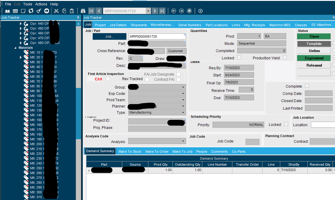

Thanks for commenting. MRP is not set to ignore constrainted material. We’re currently looking for some good examples for a material on a job that won’t be available until after the release date on the job. Here’s a screenshot of a job that we have at the moment. Let me know of anything else I can try and provide to help.

You will have to provide a bit more detail than this for an answer I am afraid as there are so many factors that affect how MRP plans jobs, especially with sub-assmblies involved, and more so when these are manufactured. Some initial questions to get you started:
- What options are selected on the sub-assembly parts in the higher level MOM (plan/pull/view) as this dictates how jobs are created (one job with multiple assemblies, or multiple jobs feeding into a top level job)
- Are the sub-assemblies stocked or non-stocked parts and if stocked are there min/max levels defined
As for upgrading, there are improvements etc. in MRP but it still relies on the underlying data being correct
