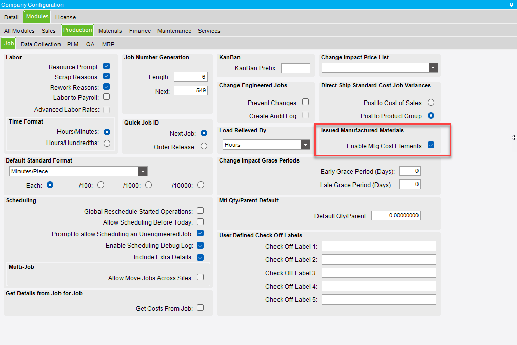

To have subassembly costs roll up in the same bucket (i.e. labor stays in labor as the job progresses), you need to set Enable Mfg Cost Elements to True on Company Configuration.

We’ve tested this and still seem to be getting the same outcome.

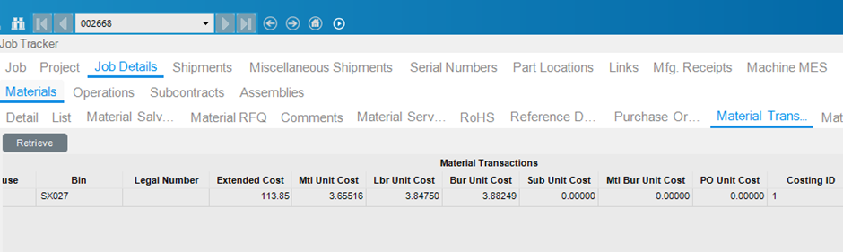

I can see the granular cost breakdown in material transactions:
But this doesn’t correspond with the unit cost breakdown in the job material detail.

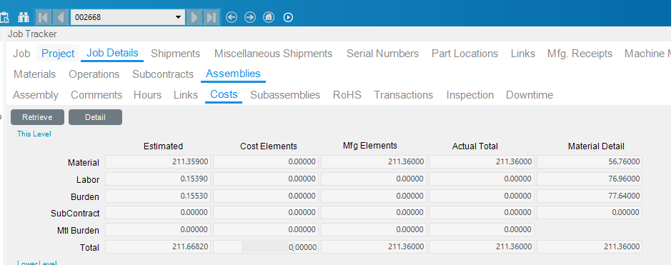

Unit cost breakdown is the estimate. Did this part have values in the segments in part tracker of the cost method you use in part tracker when the job was created.
For us the subs separated actual values will be in the assemblies tab under Mfg Elements.

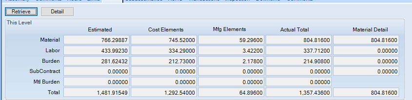

Below is a screenshot of the costs under the assemblies tab showing actual to estimate:
Jonathon

@J_Dewhirst costs have nothing in cost elements and the mfg elements has the same value as the material detail where they are broken out.
I assume that is the effect of the check box in company config.
Jobs have the checkbox, too, FYI. It defaults from the company config, but it can be changed.
I did not know that until this post:
