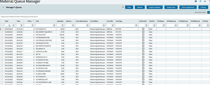

Hello we have a custom material queue done by CSG I just need to sort something out which I thought was simple, there change brought in the OTS data and also OrderHeld so the hold button on order entry however I cant hide the OrderHeld = True transactions like I could do on 10.2.700 via a hard set filter in the customisation when i do a manual filter I get an error

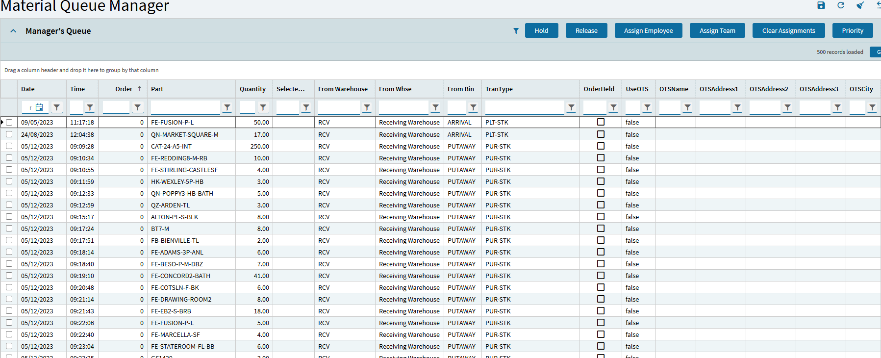

Unfortunatley I need to re-open this when I preview the application it shows as drop down but when I publish then click filters it shows box :frowning:
It looks like the layer is applied. The column changed from true/false to showing a Boolean type checkbox.
Can you not filter it at all? What are you expecting to see?
on the preview application for the dashboard it shows a drop down of true or false but on deployment it only seems to let me type in a value but then I get the same error again
