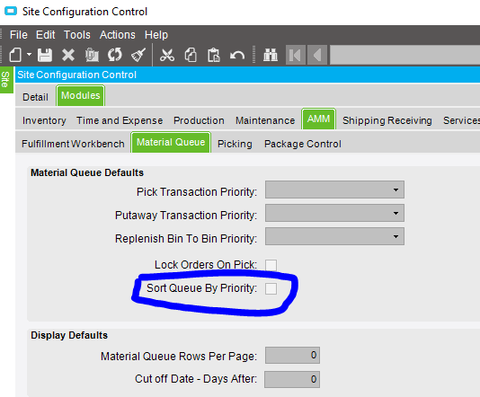

Hello @MattSpotts
May be you can check the sort transaction by priority (as a workaround).
While allocating parts in fulfillment workbench specify the transaction priority.
