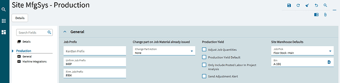

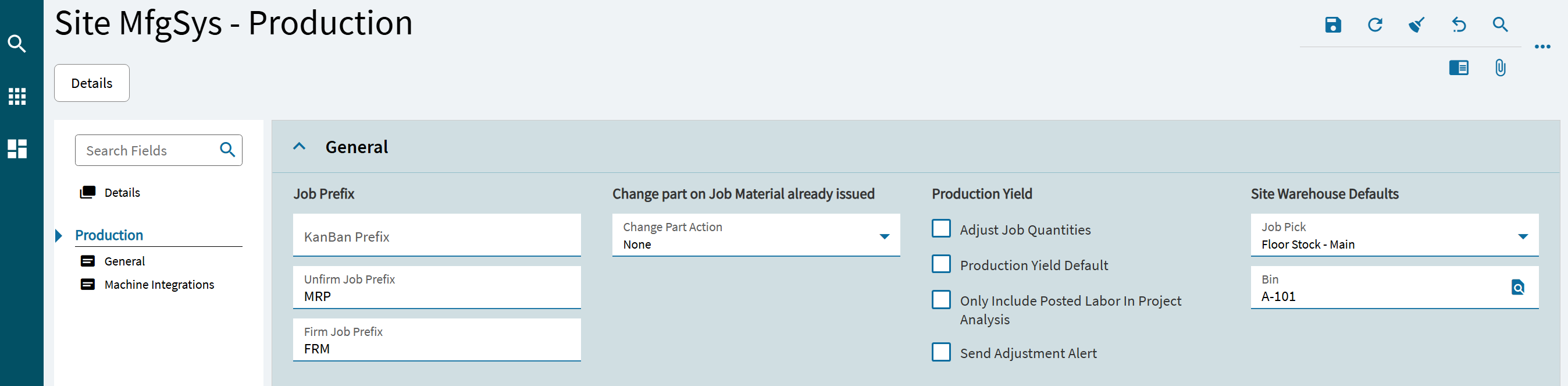

Check your site config > production > site warehouse defaults. This can override your resource groups.
I cleared the settings here. It removed the defaulting bin but shouldn’t it be smart enough to display the resource group’s bin to which that material will need to be moved to? Now it doesn’t display anything.
