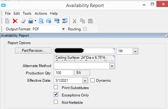

You could run the Availability report.
Production Management \ Engineering \ Reports
Select your part number and revision, Enter the Qty.
Set it to Exceptions only to see the shortages
Thanks Gil i got it…
Woow Chris , thats cool, I was exactly looking for it.
