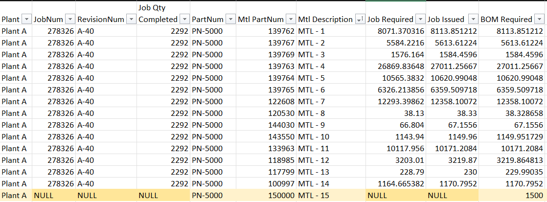

I need help with a query. I am self taught in SQL, i’d consider myself intermediate at best. I can compare the Job Materials to the Engineering BOM, this allows me to see what has been issued on the job that should not be issued according to the Eng BOM. My current query does not allow me to see what is in the Eng BOM but not in the Job BOM.

This is my results for the SQL code i’ve made. The bottom row highlighted is what i need to get added. I need to also see what is in the Eng BOM…but is not in the Job BOM.
This job produced slightly more than the Prod Qty called for, that is why the Job Required and the Job Issued don’t quite match. This is fine.
