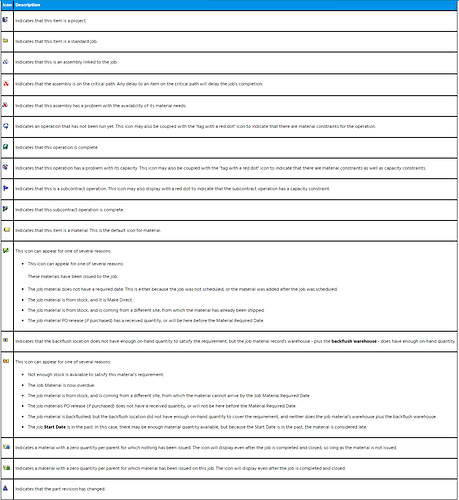

Is there a field that indicates the status of materials versus demand? Our materials team uses the color coded dots next to the materials list, but they are forced to look into each job individually and manually create a list of parts that have a demand higher than on-hand. Does anyone know if the “red dot” has a field or where that logic can be found? I can recreate it through a BAQ, but it seems like a waste to do so because Epicor has already created the logic in order to color code the dots.

Red Dot:
- Not enough stock is available to satisfy this material’s requirement.
- The Job Material is now overdue.
- The job material is from stock, and is coming from a different site, from which the material cannot arrive by the Job Material Required Date
- The job materials PO release (if purchased) does not have a received quantity, or will not be here before the Material Required Date.
- The job material is backflushed, but the backflush location did not have enough on-hand quantity to cover the requirement, and neither does the job material’s warehouse plus the backflush warehouse.
- The job Start Date is in the past. In this case, there may be enough material quantity available, but because the Start Date is in the past, the material is considered late.
