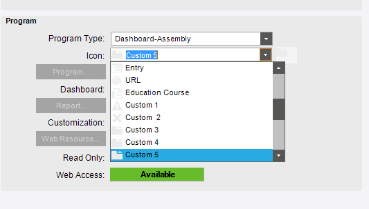

Does anyone know how to use the custom icons? Thanks!
Are you using the shell menu or the classic? If you are using the shell I don’t think you can use the custom at all (at least I haven’t found out how) if you are using classic then you need to update the resource files with the resource utility editor found in your server install location.

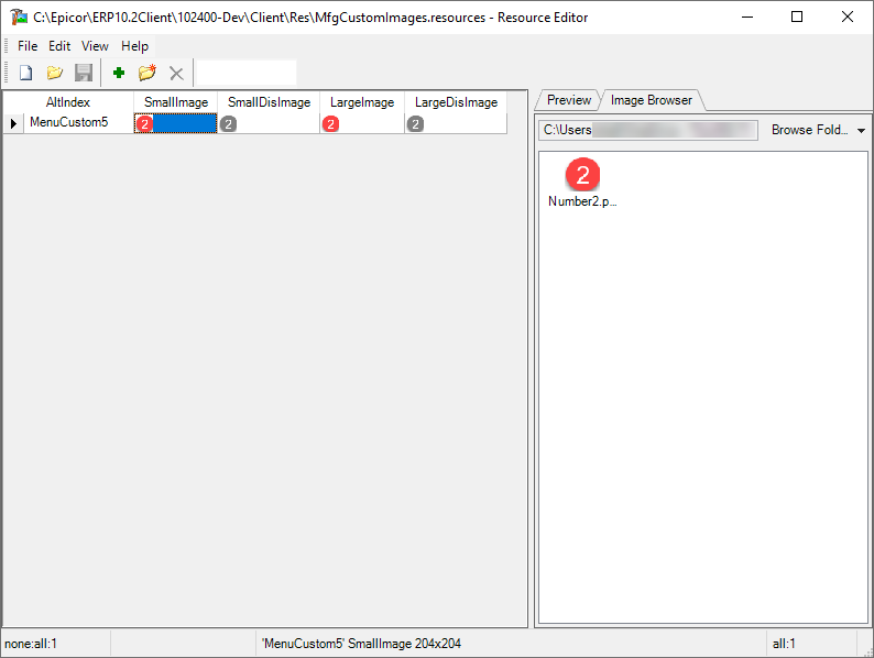

  1. Run the resource Editor (found in the Epicor\ERP10\ERP10.2.400.0\Utilities\EpiResourceEditor folder on your app server)
  2. Create a new Resource file and per the Application Online Help (search for resource editor).
  3. Add a new Resource and browse for an icon (dimensions of the image are 204/204 pixels I could not find a reference, but that’s what I used when I referenced a resource for adding a button on the handheld menu) Make sure the AltIndexname of the new entry matches the AltIndexname of the record in the MfgBaseImages.resources file in this instance I chose MenuCustom5.

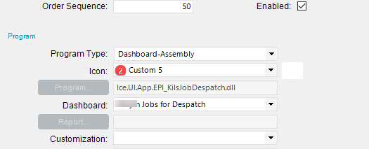

  7. Open Menu maintenance and update the menu you want to update
  8. Once updated close and log out of Epicor

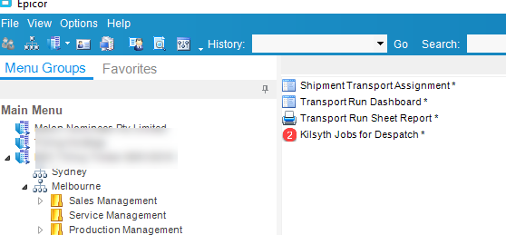

  9. Log back in using the classic mode (as @jgiese.wci mentioned there appears to be not way to do this with the Modern Shell).
  10. Navigate to your menu.
