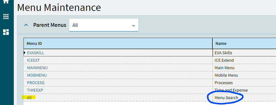

I just learned this the other day… but in Kinetic Menu Maintenance, note the bottom option “ALL” is for a “Menu Search”.
I always over-looked that option…

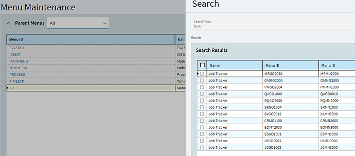

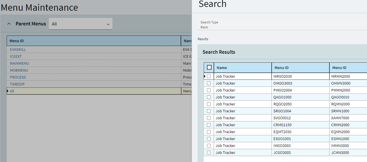

Do the search and put “Job Tracker” in the menu description:

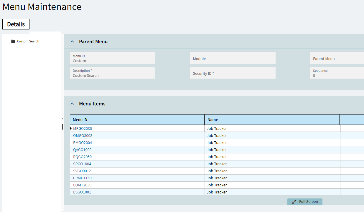

You can select all and pull them into the maintenance area:
You still have to click through, one at a time, and apply your layer… but this is a nice way to filter your menus when doing tasks like you mentioned above.
