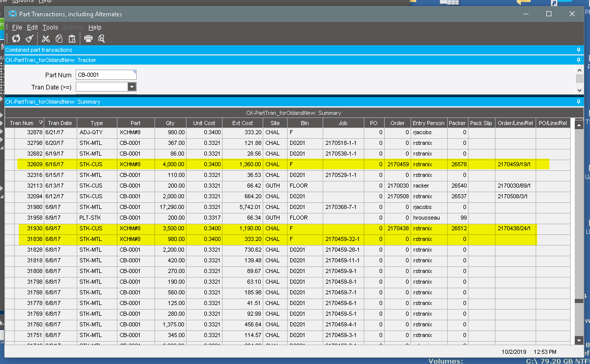

What We did was to add a field to the part master to hold the “old” number. Then created some BAQs to use as a lookup.
One BAQ we made acts like the Part Tran History. Except it retrieves transactions for both Part.PartNUm and Part.OldPN_c (and I think any of the Alternate P/Ns)
We replaced XCHM#8 with CB-0001
We also created a “Old P/N” quick search. Then anywhere you could search for a P/N, a user could search by the old P/N, but it would return the new one.
