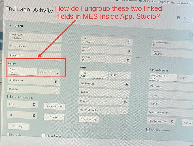

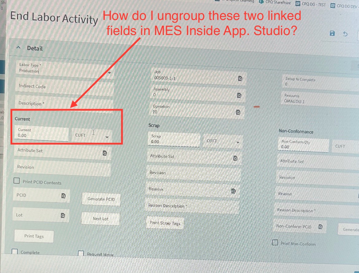

We are using the latest Kinetic version (not Classic) and need help with a couple things inside the Application Studio. We are trying to slightly alter the Office MES “End Activity” slide out screen. We’re looking for help with two options. Location - Under the first column “Current field where someone enters the numeric Qty & the UOM Drop Down next to it appear to be linked together.”

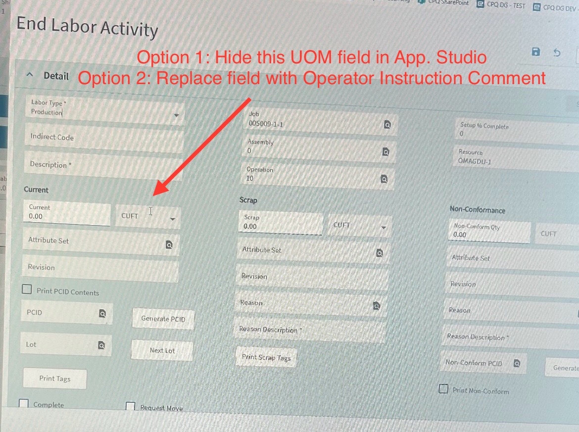

Basic Option 1: We’d like to unlink these two fields and hide the UOM Drop Down. And then our Operators will just report a qty in a known UOM for our Standard Ops Procedures.

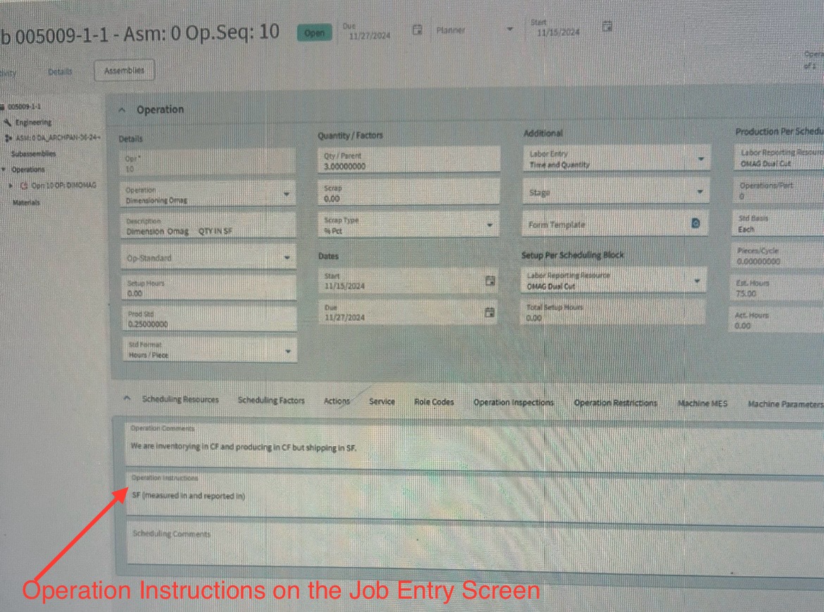

Ideal Option 2: Replace the UOM Drop Down with the Operation Instructions from the Job Entry or Job Traveler Screen (see attachments). Having trouble finding this field in Application Studio. I’m guessing we’d still need to unlink the fields described in my opening paragraph to make this change.

I don’t think you can do that.
The UOM comes from the job, which comes from the IUM for inventory on the part.
Sure you can. Just hide the field and put your own there. If it’s read only, it’s going to have the data in it anyways, so you won’t have to worry about it not populating while hidden. If it’s linked, hide both and put a new field for the quantity that’s bound to the original epBinding.
I mean, unless I’m misunderstanding the ask.
It’s not something you can change on the form.
If the job is in LF, then the labor will be reported in LF.

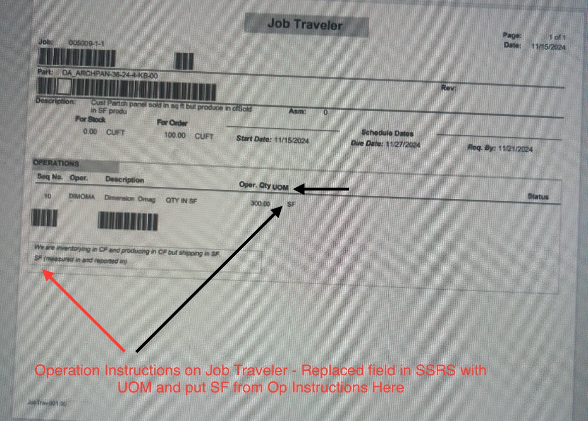

We found a way through the Native Epicor Workflow through the screenshots I shared to accommodate our solution without the user defined fields (still open to the UDF solution if someone has guidance on that). To answer your specific question, see the 1st and 2nd screenshot. When I enter the Operation Instructions as a UOM in this example SF (square feet). This then shows up in the Job Traveler through our adjustment in an SSRS Report. However, we want to look up this field or the binding and have it replace the UOM Dropdown in MES. Still show Current Qty (if we can unlink this and the UOM dropdown shown in the latter screenshots), and replace the UOM dropdown with the Operation Instruction field I described above.
