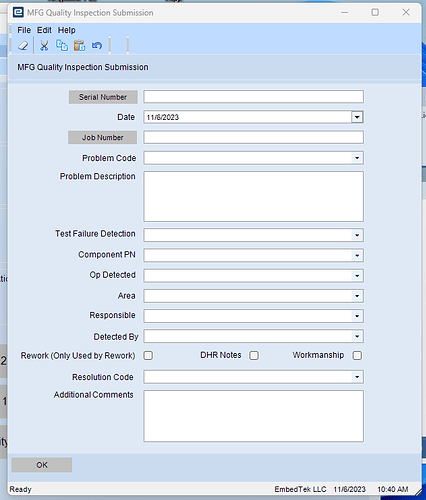

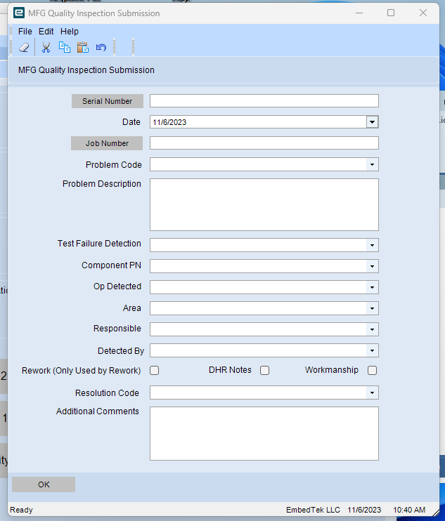

Form should look like

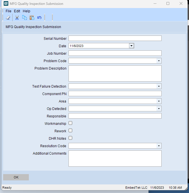

Form when user isn’t ‘Log In’

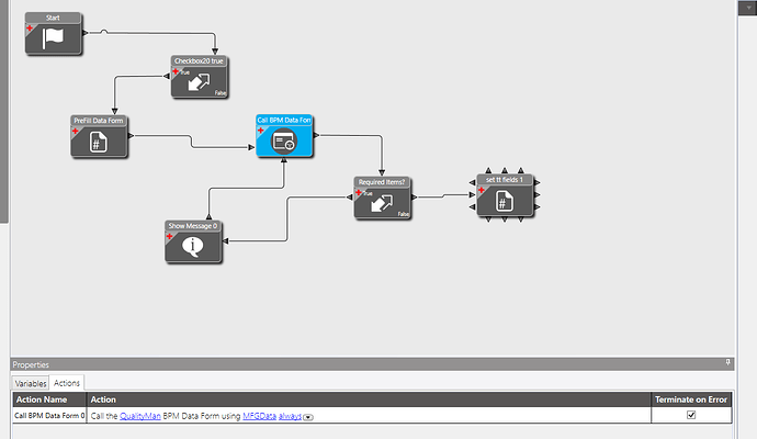

What’s the BPM look like? Tat’s interesting that unless they are clocked in it would show the non customized BPM form. Any logic in the BPM looking for Emp ID on the session?
When the user isn’t logged in the BPM Data Form is calling base.
Very odd.
So user is in MES but not “logged in” and you get base. You “log in” or “clock in” and everything is hunky dory?
What is in your prefill data form? Upload the customization export?
Correct.
The prefill data form just clears out callContext BPM Data.
as a just in case.
