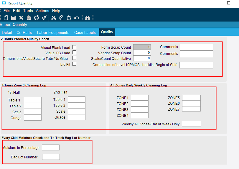

In MES -> Production - > Report Quantity Screen -> I created a new tab called Quality -> But I am not able to map to any UD table or fields.
I created an Extended UD table on JobHead (JobHead_UD) and added columns to this table (JobHead was the like column for RQ)

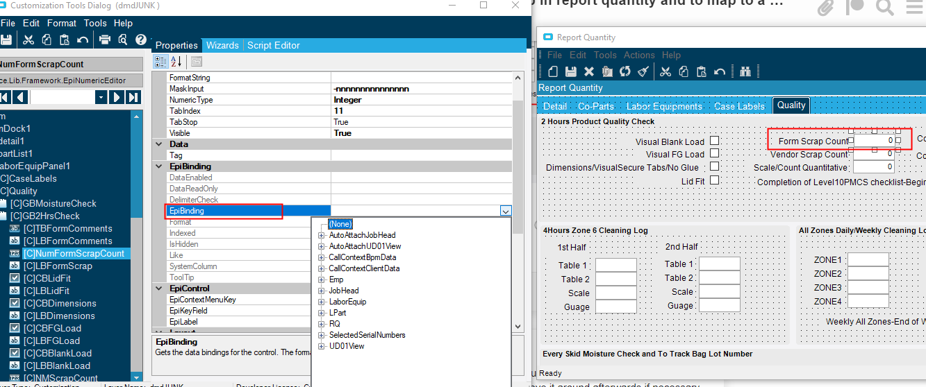

When I checked the epibindings in MES these new columns did not appear under the RQ table
I also tried creating a child table to this form by using the Wizard Add UD as a Child, unfortunately MES is limited and adding the UD as a Child does not work in this particular form.
Kindly help.

When I’ve had to work on the MES screens (and sub-screens, such as this one) in the past, I’ve always put my UD fields in the LaborDtl table, and then had BPMs to move it around afterwards if necessary.
