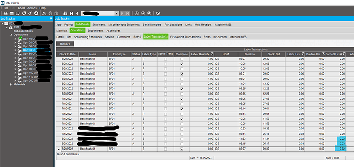

The below image is a screenshot of labor transactions from a particular operation with a setup standard with a labor entry of time only. It shows that 2 employee’s labor transactions earn hours, but Backflush’s labor transaction also earns hours. They sum up to 0.37 hours (which is the setup standard of the part).
If that was the case, then the employee’s efficiencies would be 100% which they are not all that unfortunately.
Epicor’s field help says this regarding Earned Hours. For setup when not complete, “earned hours = EstSetHours x SetupPctComplete or ActSetupHours, whichever is less”. When setup is complete, “Earned Hrs = EstSetHours - ActSetHours + SetReworkHours - Burden Hours for this labor detail record.”
This seems to be happening for some of the labor transactions. The operation is not marked complete so as the description says, Earned Hours = ActSetupHours. Since the labor time was 0.02 hours, the labor transaction reports 0.02 earned hours. This also happens for a labor transaction of 0.03 hours. Then, quantity is reported via Backflush from the subsequent operation. This initial backflush labor entry captures the remaining earned hours as defined above ("When setup is complete, "Earned Hrs = EstSetHours - ActSetHours).
All labor transactions (including backflush) that happen after this point on for this specific operation do not earn any hours. This is where the problem lies and it’s probably a result of how we have it set up right now and I’m not sure about the solution. For the purpose of capturing employee efficiency, I don’t want Backflush to earn any hours.

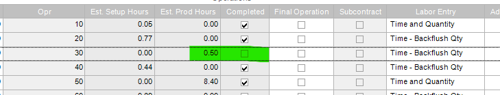

Greg, thanks for the suggestion. I haven’t found a clear definition of Fixed Hours but as the name suggests, I’m assuming that this is a UOM that is fixed, being independent of the quantity of the job (similar to how a setup time is).
I’ve just tried to test a job out switching 0.5 hours from setup time to 0.5 Fixed Hours in an operation.
The operation before and after it both have Time - Backflush Qty labor entry. When I reported the full qty for Op 50 via MES and backflushed labor, the two other Time - Backflush Qty operations displayed backflush labor transactions and the operations were completed, but the operation with Fixed Hours was not. Any idea how this happened or a solution?
I did find one attribute that looked different than the other operations so maybe this is a factor in no quantity being backflushed for this operation. The operation had “RequestMove” checked. I unchecked the box and tried backflushing labor again but nothing changed.
