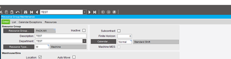

Question on MES End Activity. So we have our jobs where it back-flush all the materials and the last operation is quantity only. My question is when the employee ends activity the finish good records an entry in the material queue. Which works as expected
what i am finding out is when an employee reports quantity on a job, there is row in material request queue for warehouse to move the product. i thought that when someone reported quantity it would show in the material queue for warehouse to move but thats not happening. We even tried to report qty and then end activity and still not showing up.
