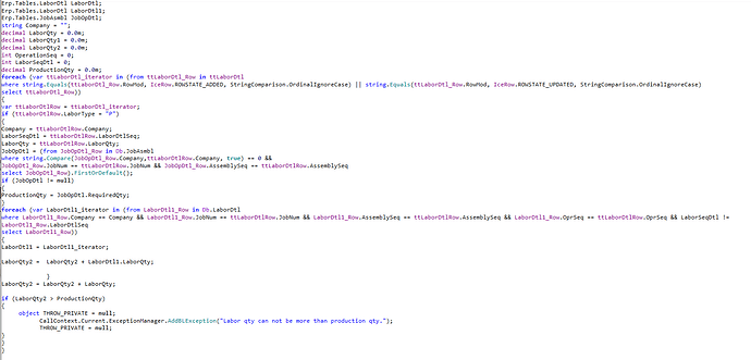

We have this at LaborDtl data directive:
Erp.Tables.LaborDtl LaborDtl;
Erp.Tables.LaborDtl LaborDtl1;
Erp.Tables.JobAsmbl JobOpDtl;
string Company = “”;
decimal LaborQty = 0.0m;
decimal LaborQty1 = 0.0m;
decimal LaborQty2 = 0.0m;
int OperationSeq = 0;
int LaborSeqDtl = 0;
decimal ProductionQty = 0.0m;
foreach (var ttLaborDtl_iterator in (from ttLaborDtl_Row in ttLaborDtl
where string.Equals(ttLaborDtl_Row.RowMod, IceRow.ROWSTATE_ADDED, StringComparison.OrdinalIgnoreCase) || string.Equals(ttLaborDtl_Row.RowMod, IceRow.ROWSTATE_UPDATED, StringComparison.OrdinalIgnoreCase)
select ttLaborDtl_Row))
var ttLaborDtlRow = ttLaborDtl_iterator;
if (ttLaborDtlRow.LaborType == “P” )
Company = ttLaborDtlRow.Company;
LaborSeqDtl = ttLaborDtlRow.LaborDtlSeq;
LaborQty = ttLaborDtlRow.LaborQty;
JobOpDtl = (from JobOpDtl_Row in Db.JobAsmbl
where string.Compare(JobOpDtl_Row.Company,ttLaborDtlRow.Company, true) == 0 &&
JobOpDtl_Row.JobNum == ttLaborDtlRow.JobNum && JobOpDtl_Row.AssemblySeq == ttLaborDtlRow.AssemblySeq
select JobOpDtl_Row).FirstOrDefault();
if (JobOpDtl != null)
ProductionQty = JobOpDtl.RequiredQty;
foreach (var LaborDtl1_iterator in (from LaborDtl1_Row in Db.LaborDtl
where LaborDtl1_Row.Company == Company && LaborDtl1_Row.JobNum == ttLaborDtlRow.JobNum && LaborDtl1_Row.AssemblySeq == ttLaborDtlRow.AssemblySeq && LaborDtl1_Row.OprSeq == ttLaborDtlRow.OprSeq && LaborSeqDtl != LaborDtl1_Row.LaborDtlSeq
select LaborDtl1_Row))
LaborDtl1 = LaborDtl1_iterator;
					       LaborQty2 =  LaborQty2 + LaborDtl1.LaborQty;
LaborQty2 = LaborQty2 + LaborQty;
if (LaborQty2 > ProductionQty)
     object THROW_PRIVATE = null;
           CallContext.Current.ExceptionManager.AddBLException("Labor qty would not be more than production qty.");

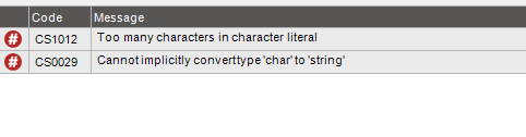

I made some changes where needed and am still getting one error I can’t figure out…
Operator ‘==’ cannot be applied to operands of type ‘string’ and ‘char’
Make sure you have regular quotes here. Without encoding the code in the post with the CS block, it converted it into the “formatted” open/closed quotes.
```CS
string Company = "";
if (ttLaborDtlRow.LaborType == "P" )

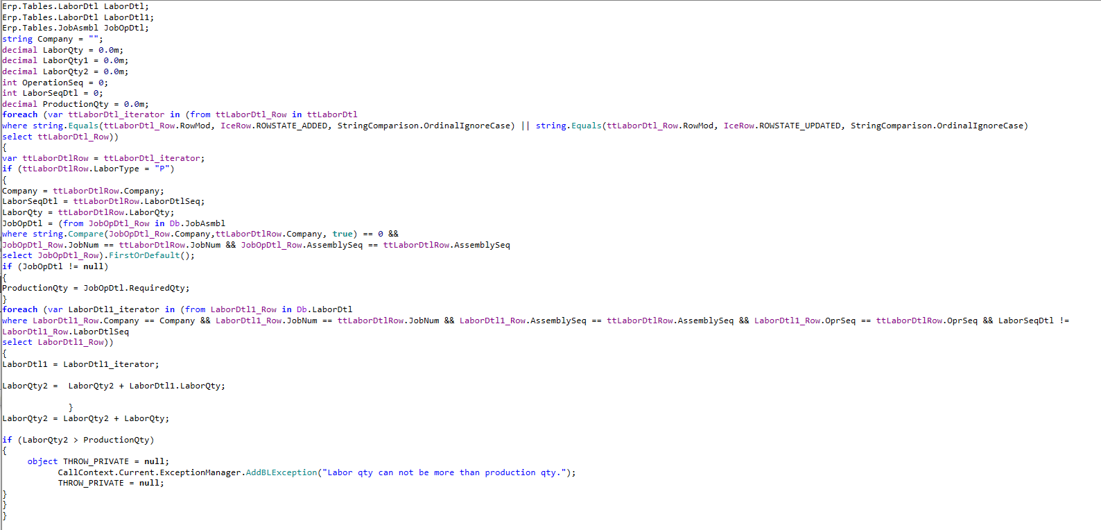

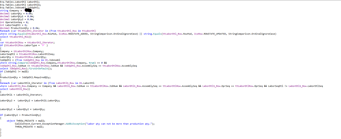

So have those fixed, but still getting these errors. Here are picks of what I have and the errors.
This is what you have:
string Company = '???';
if (ttLaborDtlRow.LaborType == 'P' )
It should be
string Company = "???";
The single quote (') is used for the character data type in C#, the double quote (") is used for strings.

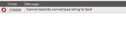

Ok…got it! Made those changes, and have this final little bugger.
You only have one = in the test for “P” … it needs to be ==
It should be
