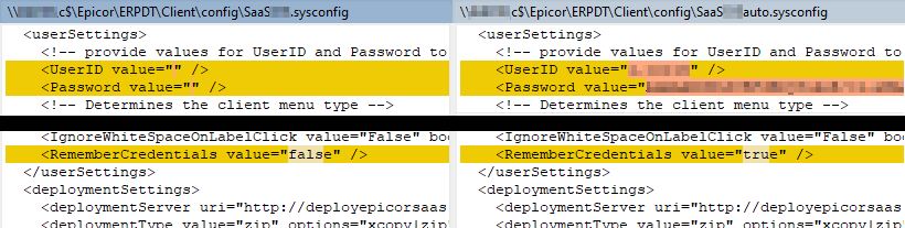

We had a minor Epicor update over the weekend (2021.2.13) Now the MES shortcuts on the machine shop PCs downdate Epicor and it cannot run. Our MES shortcuts are set up to use a separate sysconfig file and are in the startup folder so that MES auto-logs in when the PC is rebooted. The only difference in the separate sysconfig file is the auto-login parameters:

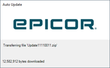

It downloads and runs AutoUpdate.zip, then downloads and runs Update11110011.zip:

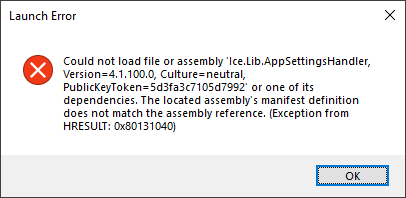

Then it shows this error:

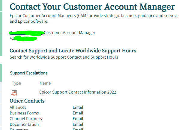

Huh. It’s on EpicWeb, not EpicCare.
Here:
https://epicweb.epicor.com/resources/Pages/contact.aspx
And click the PDF link. (Bottom of page 6 - Kinetic support)
Obviously I’m not going to post the actual document in a public forum.
But don’t be shy to escalate. That’s what Leigh has told me - and she is one of the senior support heads.
