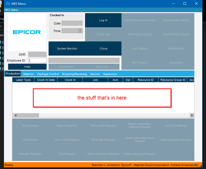

It’s because when you do stuff in the work queue, you may need to refresh the stuff that’s on the main MES screen. Specifically, the active work that shows up on the main screen.
If it let you work on both screens, then actions that you can do with what’s in that grid can be out of sync and cause issues.
That’s kinda what I figured. Thanks ![]()
