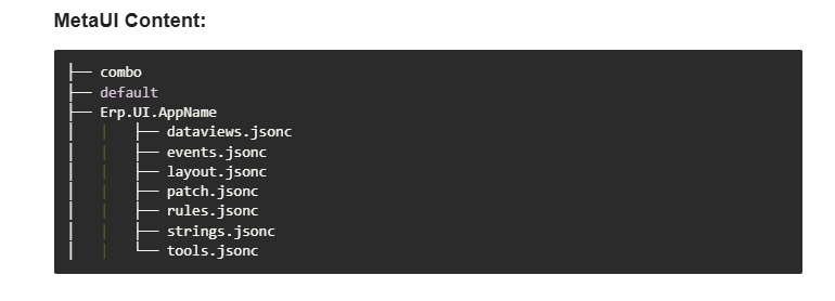

I mean, a textual respresentaion of an app is a sub-dir by appName having additional subdirs and files for layout, event, rules etc. Ideal for SCM persistance and diffing. if we really had our way wouldn’t we even prefer to deploy layers to disk not db?

I’ve been toying with the idea of a VSCode extension for what you’re talking about. I want the format that the browser uses from GetApp and not the three sub folders in MeatUI. Of course with Git integration, which the EpiDevs do use…
Yes, because source control isn’t built on cache!

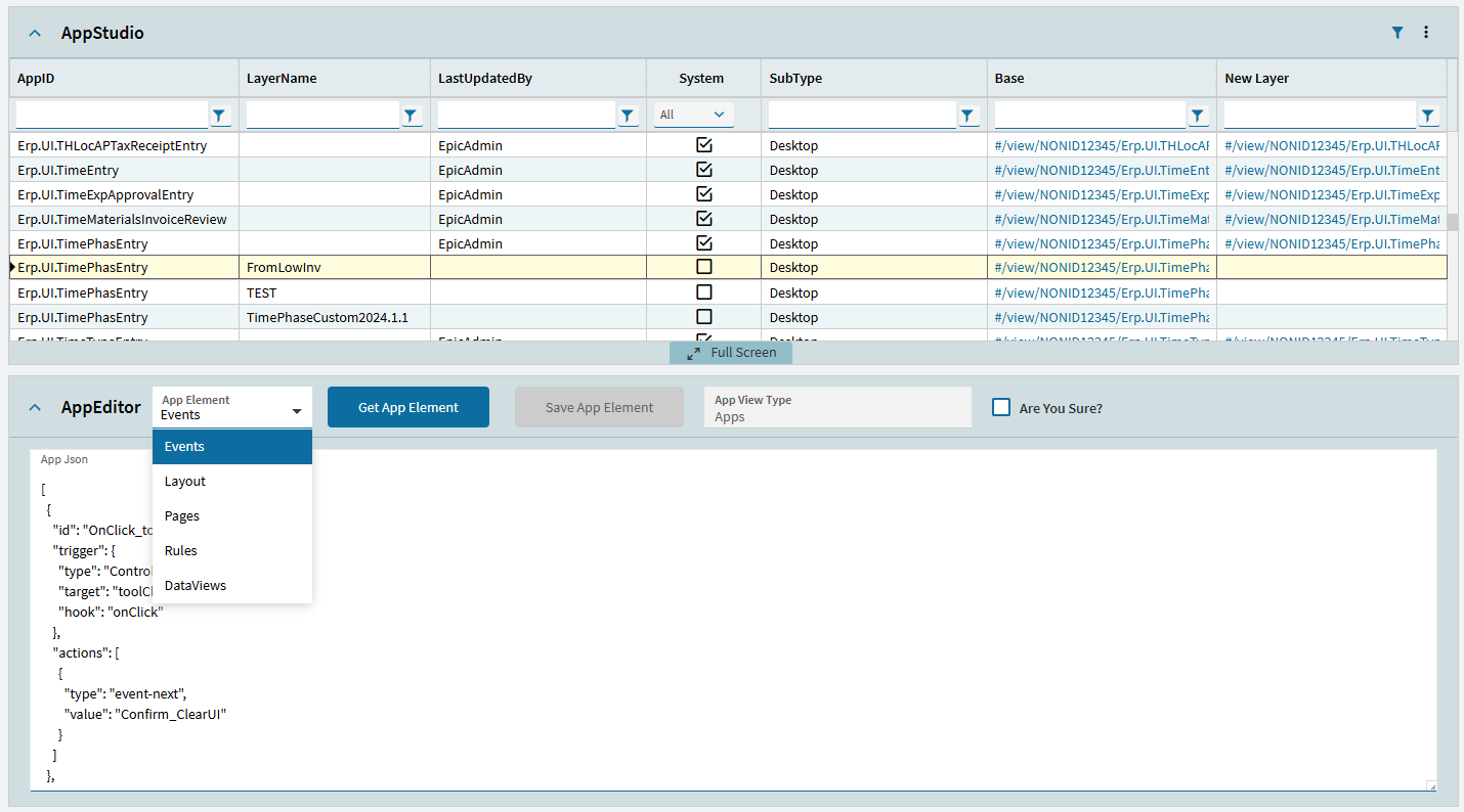

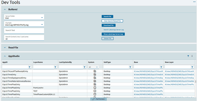

Dev Tools Dashboard has an app json viewer that will let you walk through all the oob (and custom) jsons direct in the dashboard, always up to date because it’s right out of your database :slight_smile: I use it for a reference a lot for the same reason. I also use it to directly edit the events json in my apps for complicated flows that I dont want to gui-fy. And columns arrays on grids. The dir/subdir concept for app/events/layouts/pages/rules is there too just in a pub sub instead of folder structure :grinning_face:
All your MetaUIs belong to us.:
(also, the links under base/existing/new layer will launch app studio to that applicable item, i optimized this for load time because app studio’s landing page is atrocious.)
Hide your Events, Layout, Pages, Rules, and DataViews, because we’re comin’!
Also, if you are editing a draft layer, you can tell the dashboard you are sure (so that you can’t blame me for what you break), and hit Save App Element.
This will update draft layer to reflect the json changes. You can have appstudio open to the app, edit json in dev tools, then f5 to refresh app studio and see the changes you did. (then publish etc. as normal from there)
If you would like a feature request for a download button to download all the metaui zips, feel free to feature request on my thread and i will add :slight_smile:
Note: There is an open bug with 2025.2 compatibility, and saving app json, (the dashboard is coded to work with 2025.1 and there was a change to the BO Signature for GetApp/SaveApp between versions) - someone posted a fix on my thread. when i got around to it i was going to figure out how to put a version check so i can case out the logic to behave appropriately for 2025.1 and 2025.2.
Here is the link for relevant post about editing json and the gotchas.
https://www.epiusers.help/t/dev-tools-developers-swiss-army-knife-server-logging-file-download-efxeditor-appstudiojsoneditor-baqaliaseditor-reporteditor-bpm-on-the-fly-kinetic-dashboard/127887/15?u=gabefranco
Grab the latest version v12 from last post :wink:

Ok. to each their own I guess. there’s a reason the file structure is that way and not the GetApp conglomerate. Separation of Concerns and Single Responsibility Principle for examples. Each file has its own schema def. Seems quite likely if dev team is doing json editing, they’re working in these base formats not db and not GetApp format. GetApp is a conglomerator. Guessing it generates from source (whether db or disk doesnt matter) and merges layers for browser consumption. Who knows.
