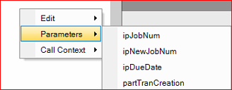

Using other samples from this website, I have tried many combinations of field value assignment to update a split job’s comment fields from the original job’s comment fields. The error message received is “CS0103 - The name ‘jhn’ does not exist in the current context”. It also repeats for the jho (original job row).
I have tried the following:

Here’s the custom code:
//Erp.Tables.JobHead JobHead;
using (var txscope = IceDataContext.CreateDefaultTransactionScope())
// Get the Orignal Job
var origJob = (from jho in Db.JobHead.With(LockHint.NoLock)
where jho.Company == callContextClient.CurrentCompany
&& jho.JobNum == ipJobNum
select jho);
if (origJob != null)
//Get the newly created (split) Job
var newJob = (from jhn in Db.JobHead.With(LockHint.UpdLock)
where jhn.Company == callContextClient.CurrentCompany
&& jhn.JobNum == ipNewJobNum
select jhn);
if (newJob != null)
{ //jhn.PartRevDescription_c = jho.PartRevDescription_c;
//newJob.jhn.PartMfgComment_c = origJob.jho.PartMfgComment_c;
//newJob.PartMfgComment_c = origJob.PartMfgComment_c;
jhn.PartMfgComment_c = jho.PartMfgComment_c;
Db.Validate();
txscope.Complete();
