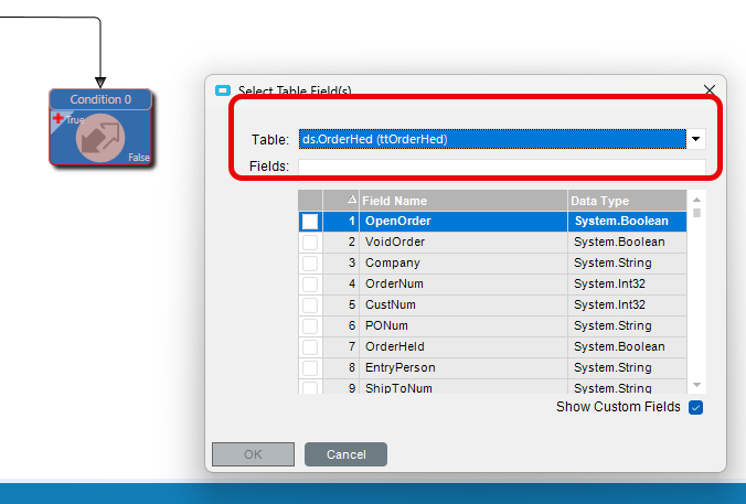

How would i get the field from the CustIC table into the condition ?
I’d like to select a field from the CustIC table within the condition, is there anyway this can be done?
You won’t be able to get the CustIC field using that option, as it isn’t one of the tables in the SalesOrderTableset. You can get the IC Code using a LINQ query if you put it in a custom code block like the one below. If you set a BPM string variable, you can persist the ICCode so you can later use it to update your sales order UD Field.
