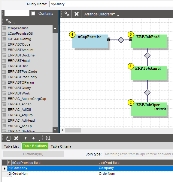

Let’s start with the first issue; the condition and Linq statement. My condition is a query, if number of rows is more or equal to 1. I can’t use Job Number to link the CTP tables to the Job tables as the CTP job number is returned as “CTP123456789”, but the final resulting job number, what I’m looking for, is “123456-x-x”. So I’m going by order number instead.
In my code, this is how I’m trying to grab my job operation data:
foreach (var ttCapPromise_iterator in (from ttCapPromise_Row in ttCapPromise
select ttCapPromise_Row))
var ttCapPromiseRow = ttCapPromise_iterator;
JobProd = (from JobProd_Row in Db.JobProd
where string.Compare(JobProd_Row.Company, ttCapPromiseRow.Company, true) == 0
&& JobProd_Row.OrderNum == ttCapPromiseRow.OrderNum
select JobProd_Row).FirstOrDefault();
if(JobProd == null)
this.PublishInfoMessage("No job production information", Ice.Common.BusinessObjectMessageType.Information, Ice.Bpm.InfoMessageDisplayMode.Individual, "", "");
if(JobProd != null)
JobOper = (from JobOper_Row in Db.JobOper
where string.Compare(JobProd.Company, JobOper_Row.Company, true) == 0
&& string.Compare(JobProd.JobNum, JobOper_Row.JobNum, true) == 0
select JobOper_Row).FirstOrDefault();
