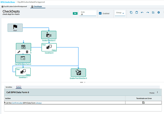

In classic we have a method directive to check the employees department when they submit a time entry. The method is pre Erp.BO.Labor.SubmitForApproval. Inside this BPM, we pop a BPM Form to ask yes/no question. This works great in classic, but in Kinetic I got this error:

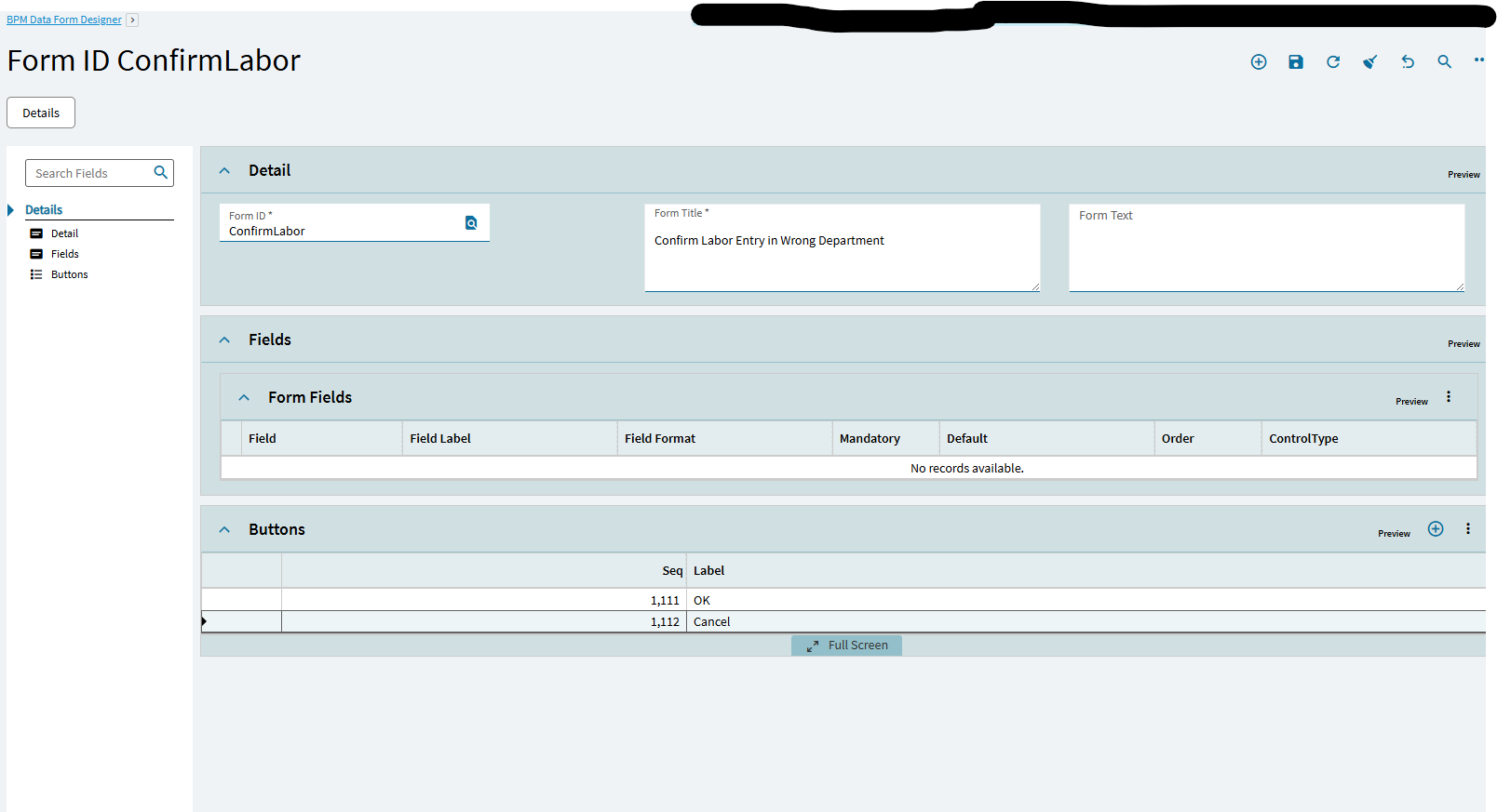

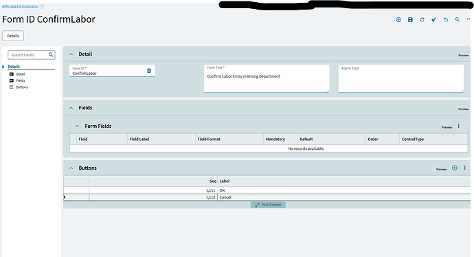

I went into the method and made sure the form was valid. I also went into BPM Data Form designer to make sure the forms are saved and valid. I don’t see any issues. Do I need to call BPM data forms differently from Kinetic?

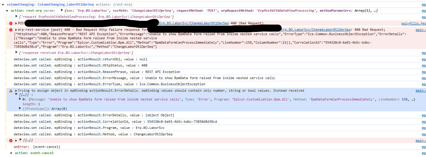

Here is what I can see in the dev console:
I was mistaken before. The directive I am working on is actually post Erp.BO.Labor.DefaultOprSeq. Same idea though, we pop a BPM form ask if the user is sure, and either cancel the method or let it finish.
I removed the old methods, and just used a new pre method on ChangeLaborDtlOprSeq. The issue was related to how I had customized the BPM data form in classic. Kinetic doesn’t want to use customized forms, so I had to remove that part from my method directive. Seems to work now. Thanks for the guidance!
