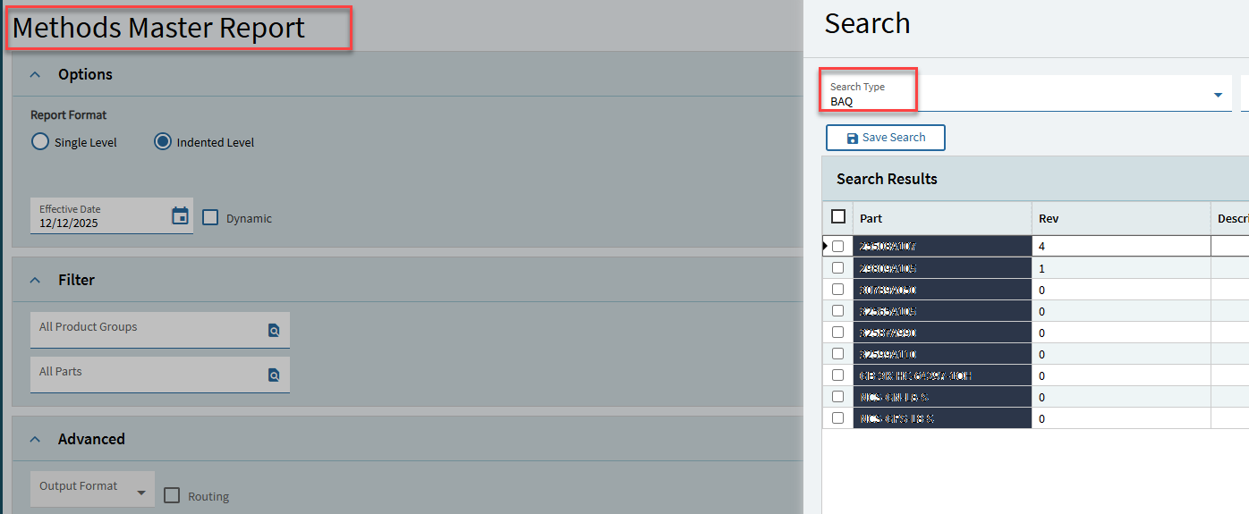

My work around was that i created a searchable BAQ as show above. It shows all the parts and approved revs i need. I am able to select them all but it does nothing. It doesn’t bring these parts in.

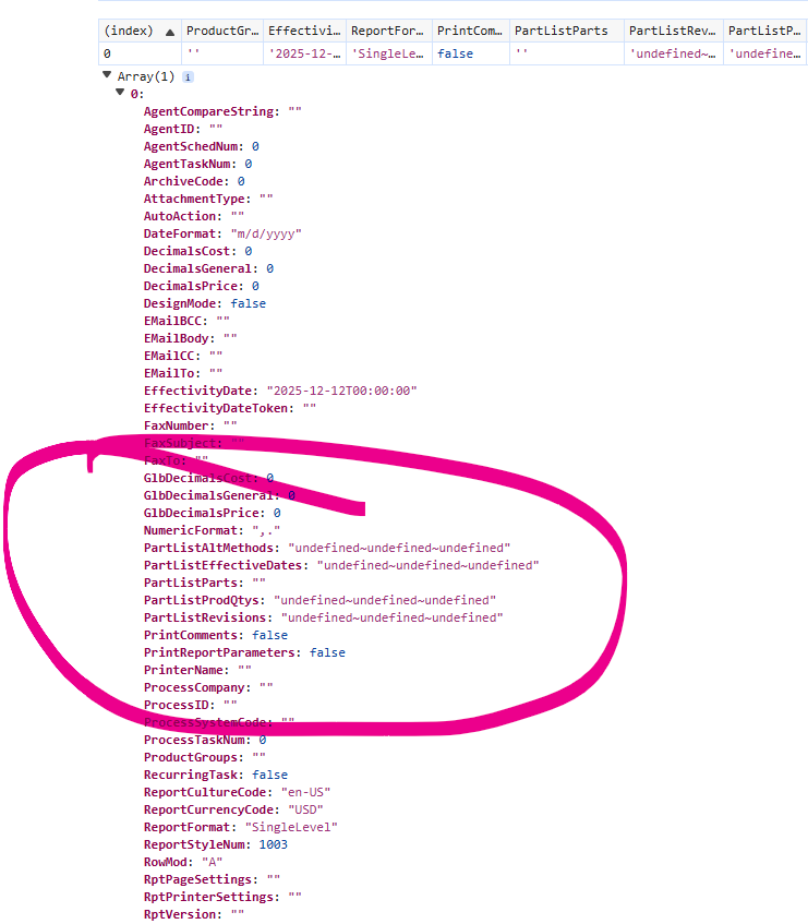

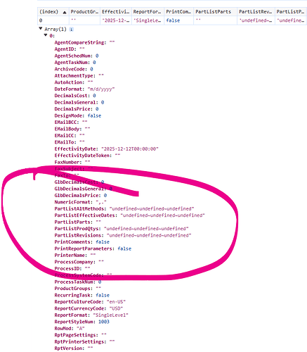

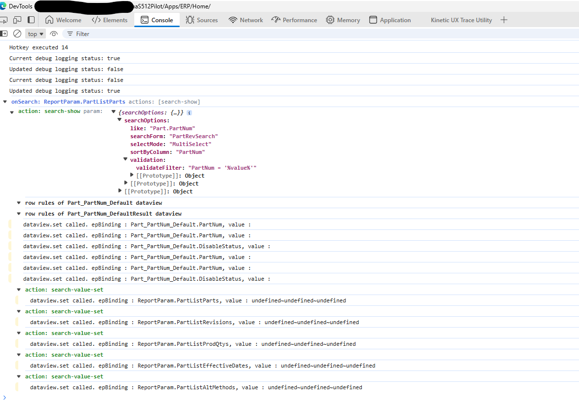

Here I replicated your approach and you can see that the ReportParams are being set to undefined~undefined~undefined, instead of the three part/revs I choose from my BAQ.
The issue seems to be passing values to the filter from the BAQ Search. I don’t have a solution, but perhaps this helps someone else.
I am thinking if we can get values into the various areas where it says undefined here, we might get a good result.
I can understand all the other fields it lists as undefined, but why ProdQty? Hmmm…

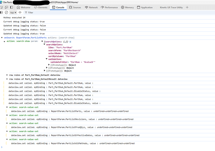

When I pass in parts from my BAQ search, I can see them in searchResult. Now how to get these into the undefined lists…

Yes, also using dev mode (F12) in the browser. There is a post here somewhere with information on how to use it. Like Ctrl+Alt+8 to turn on debug, and Ctrl+Alt+V to see the dataviews.

Regarding BAQ search: there is an event on the App that contains a search-show followed by search-value-set actions which set the 5 ReportParams from actionResult (why not from searchResult? :man_shrugging: )
I believe the problem with the BAQ search may be that the field names in the setters don’t align with those the BAQ due to Table_FieldName format in BAQ columns
For example, if you copy/override the event and change the search-value-set from actionResult.PartNum to actionResult.Part_PartNum, you get the list rather than undefined in ReportParams
However, now standard search is broken so I suspect BAQ search is meant to work without this change but :man_shrugging: - refer to first sentence :backhand_index_pointing_up:

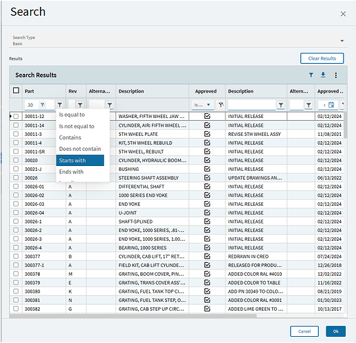

Yeah, wow, this is pretty useless unless you have a single part (or the ones you need just happen to be at the top of the list!).
I’m on 2024.2. I think it’s the same issues as you see on 2025.x.
Some broad thoughts though:

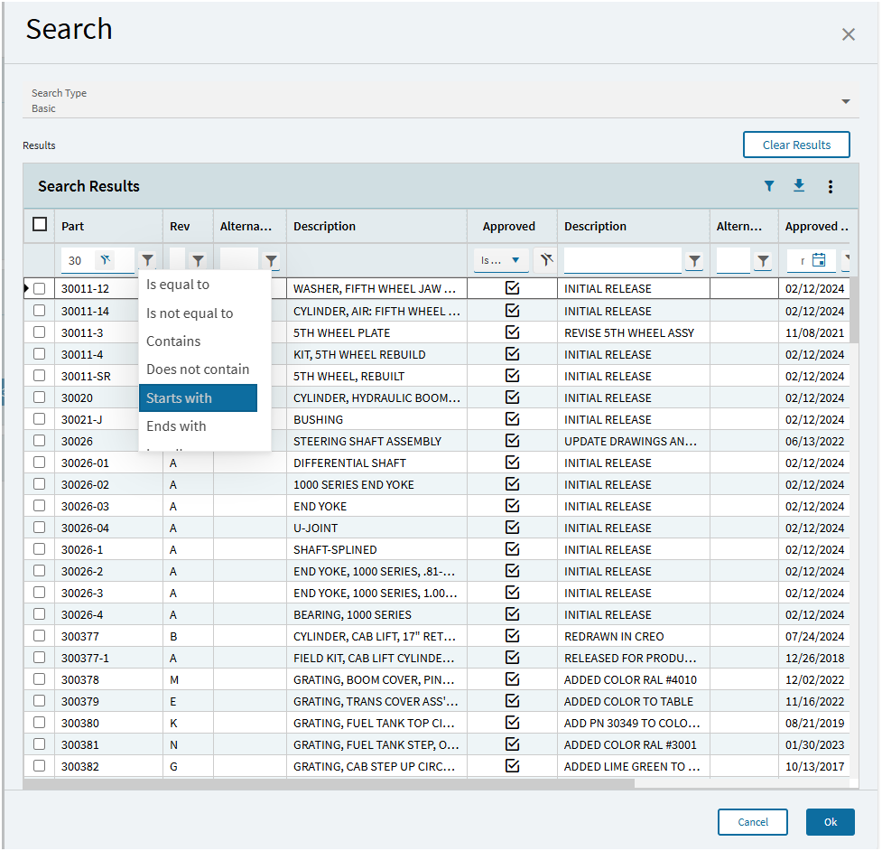

  1. You can filter the grid, e.g. on “Approved = true” or “Part begins with 94” etc.
    a. Maybe you can drill to what you need within a few scrolls and then select the needed items.
  2. The first pic shows I cannot filter by (Part) description. But…

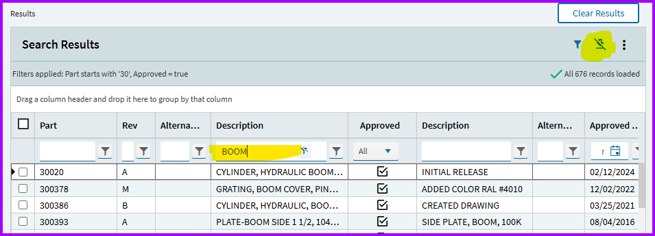

  3. If you “download” some (all) of the records, you can then filter on description - for the records that have been downloaded.

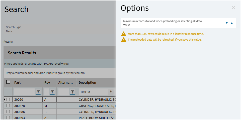

  4. You can change the “options” for how many to download at once.

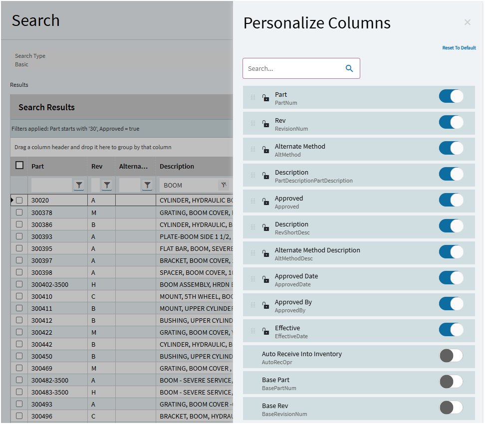

  5. [Edit] Also, you can personalize the columns of the search and maybe there is one in there that will help you filter to what you need.
If you dig in, I think you’ll find there are some Revs with blank AltMethod which causes that ReportParm to have fewer list items than the others.
The way they are setting the ReportParams from actionResult doesn’t handle this well.
