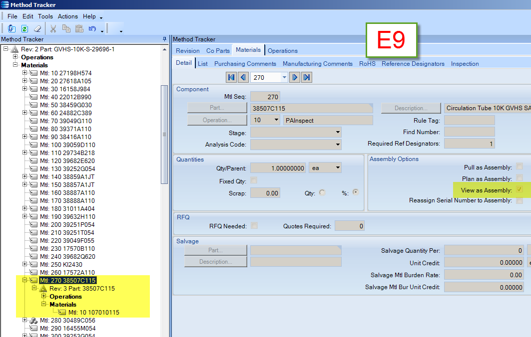

Since going live on E10 three weeks ago, we are seeing Method Tracker strange behavior where some parts are not showing lower levels, where they used to in 905702a. I haven’t been able to figure out why some show and some don’t but can see it used to show in E9 and now does not in E10. The culprit parts are checked view as assembly.
Anyone else have any thoughts on when the see the lower levels in method tracker for a part in E10 vs when they don’t?

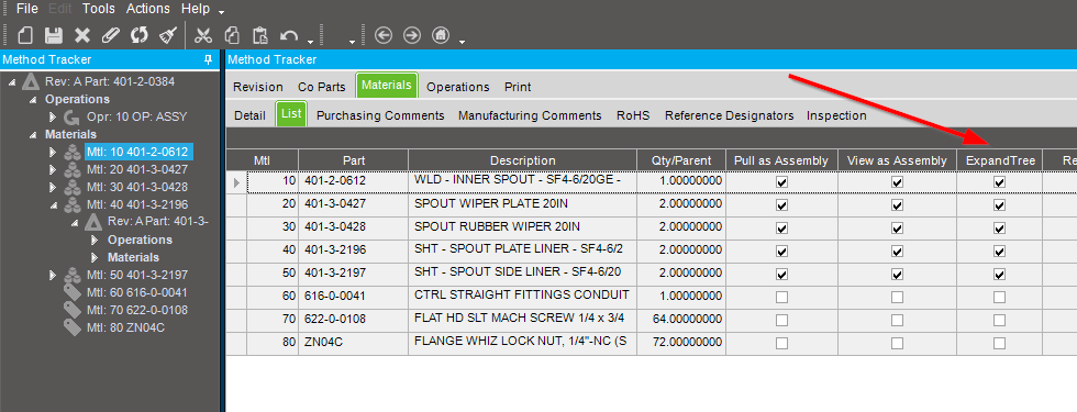

Also, just out of curiosity, I’ve seen this field in the list, but have never seen what it does. Does that part that the ExpandTree field checked?
Thanks for your suggestions. I do indeed have part revision in for all of them and Expand tree is checked for all.
