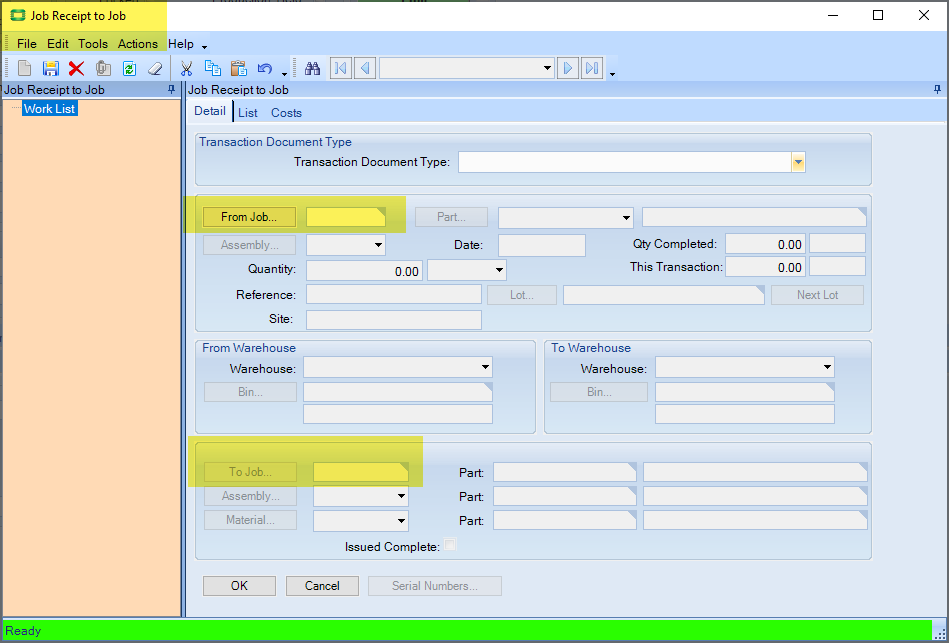

May I know which screen and step to perform this transaction?
Hi Shantanu,
See screenshots below. We don’t do this anymore because of the difficulties it caused. But here’s an example from 2012. The parent job was setup to pull make direct on a matl in the BOM that was getting mfd in a different plant than the parent job. Job receipt to job was used to get the part on the parent job.
