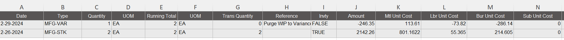

  1. The MFG-STK amount (from the Part Transaction History Tracker) divided by the number of units
  2. Minus actual cost for one unit
  3. The difference of these two lines is then multiplied by the number of units
  4. And that product is what is we see in the usage variance.
For example:
Order #: 1807

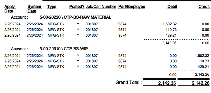

  1. The MFG-STK for one unit is:
    Date
    Type
    Quantity
    Job
    Invty
    Amount
    Mtl Unit Cost
    Lbr Unit Cost
    Bur Unit Cost
    Sub Unit Cost
    2/26/2024 12:00:00 AM
    MFG-STK
    2
    1807
    TRUE
    2142.26
    801.1622
    55.365
    214.605
    0
  2. Minus actual cost for one unit is:
    Quantity
    Job
    Amount
    Mtl Unit Cost
    Lbr Unit Cost
    Bur Unit Cost
    Actual cost of Job for 1 qty :
    857.97
    18.46
    71.54
  3. The difference of these two lines is then multiplied by the number of units:
    MFG-STK Mtl Unit Cost
    Lbr Unit Cost
    Bur Unit Cost
    Sub Unit Cost
    801.1622
    55.365
    214.605
    0
    Actual cost -857.97 -18.46 -71.54 0
56.80 -36.91 -143.07 0
Number of units x 2 x 2 x2 x2
Total: 113.61 -73.82 -286.14 0

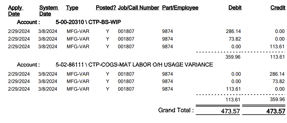

This amt. is posted in
the usage variance account.

At the moment, all of the cost is going to MFG-VAR and is not distributed between the WIP accounts. Could you please advise what I can do so the cost is allocated to the appropriate WIP account?
As a reminder, when the JOB were opened, part number: XYZ had $0 in standard cost, after the job was closed, I updated the standard cost to what is listed now as the standard cost for this part. My question is, is there a way to update the JOB now that there is a standard cost, so the cost is allocated to the corresponding WIP account instead of all the cost going to MFG-VAR as it is now.
As the job is closed, you will need to use Job Adjustment as long as the transactions have not been posted to GL. If it has been posted to GL, you will need to do a correcting journal entry (although this will not update the job).
