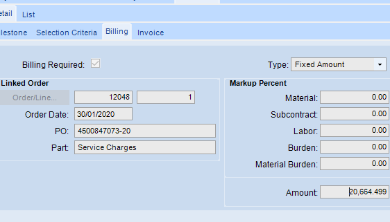

We are generating an AR Invoice from the Project as “Milestone Billing” we want to generate exactly value without any rounding off.
Milestone is 20,664.499

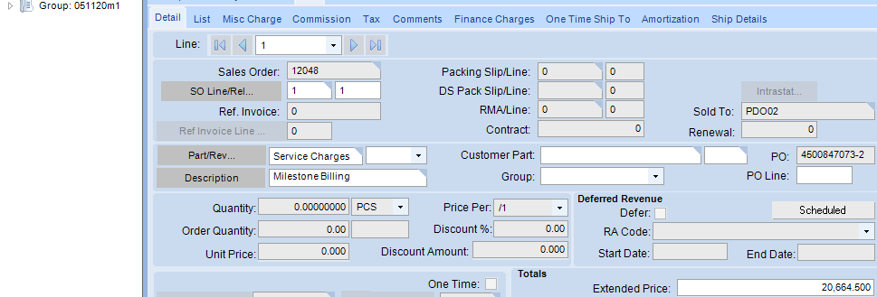

The invoice is generated 20,664.500.

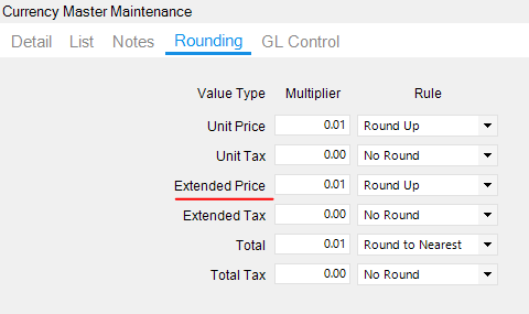

The Extended Price applies the currency rounding rules, keep in mind this applies to a lot of places in AR.
