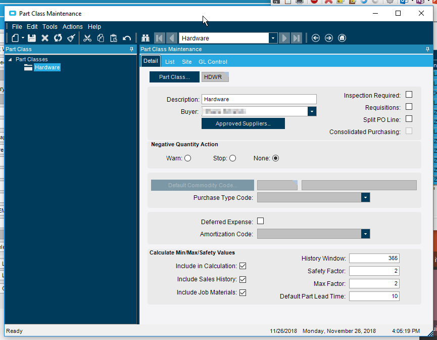

I’m just clicking around so I could be totally wrong, but it seems to be related to the part class settings and what’s included in the calculations there. If I search by part, and don’t have any of these checked, I get nothing (like you)
After I check them, I get an exception, so it’s trying to do something, but I can’t figure out what…

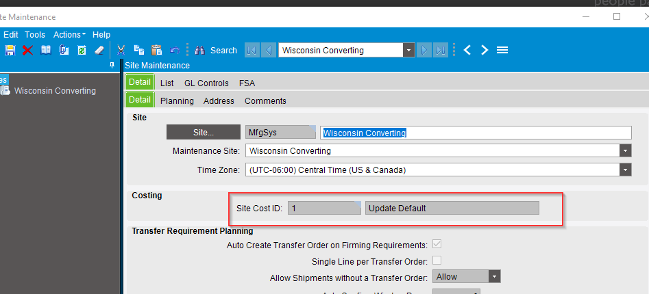

Issue of mine fixed with setting the plant cost id on plant record. You need to run trial balance before and after setting this IN TEST and ensure the amounts tie out the same. If they do, set the cost ID from the Actions menu in production and away you go!
We have the same thing happening and opened a case with Epicor yesterday on it. We were using this program in 10.2.200.6 without issue but now that we are in 10.2.300.3, it no longer works. We get the same system.decimal error as you. I spoke with Epicor on this case for a while and they did not get the error in 10.2.300.4 so they think it may be a bug. We are working with them for resolve on this now. We do not want to upgrade again (we just went to .300.4 on 11/3) so we are hoping for a fix.
I posted the fix. Add Plant Cost ID to your site record and it should be ok. If you have multiple buyer beware there are GL impacts here.
