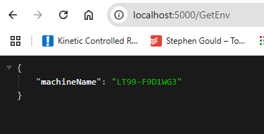

The edge agent isn’t “special” in any real sense… There’s very little stopping you from having your own Ashworth Agent. (Its just a local web server)
I wouldn’t put any private information on it but something as simple as the work-station ID is pretty harmless
Something like this:
Runs at : Localhost:5000/GetEnv
And return the machine name
Normally having an outward facing “web server” listening for requests on LocalHost and responding to anyone who calls is a no no… But honestly the machine name is harmless. If you want to make it more robust you could make sure that the source is a specific URL (like edge agent does)
IN App studio all you have to do is make a call to this and grab the info and do with it what you wish. Maybe the Edge agent already has an endpoint which includes System Info but I couldn’t find one @Olga may be able to point us in that direction if it exists.
AshAgent
RowUpdate
"#_JSON.parse((() => { const x = new XMLHttpRequest(); x.open("GET", "http://localhost:5000/GetEnv", false); x.send(null); return x.responseText })()).machineName_#"
Yes you will have to install this on every workstation.

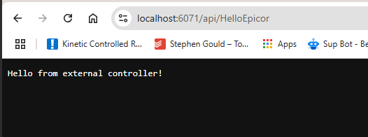

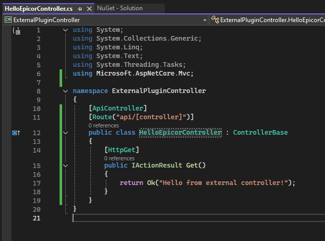

You could also get SUUUUUPER Hacky (don’t do this) and Wedge it right into the existing edge agent
Seriusly don’t do this… but if you do… it might look like
:zany_face:
This
Wedge EdgeApp.dll Startup class
services.AddControllers().ConfigureApplicationPartManager(delegate(ApplicationPartManager apm)
				string path = Path.Combine(AppContext.BaseDirectory, "Plugins");
				if (Directory.Exists(path ))
					foreach (string fileI in Directory.GetFiles(path, "*.dll"))
						try
							Assembly assembly = Assembly.LoadFrom(fileI);
							apm.ApplicationParts.Add(new AssemblyPart(assembly));
						catch (Exception ex)
							Console.WriteLine("Failed to load plugin: " + fileI+ ", Exception: " + ex.Message);
Then Make your own controller
Drop file in new Plugins folder..within Edge agent install location
and…
Then … #Profit

It does not have THAT plugin capability :rofl:
Jose will have to re-add the code on each reinstallation
It doesn’t I added it :rofl::rofl:
But its a good idea and it takes 2 lines of code so maybe someone can add it for us…
